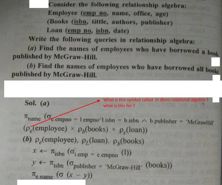

Here is a problem and solution given in my book.
this is using a symbol in cartesian product .
I checked other books for cartesian product examples but there was no such symbol being used.

I just looked this up. That is the greek character rho (##\rho##) which means rename according to wikipedia. So employee is renamed to e, books to b, loan to c, then it creates the cartesian product. Does that help?

I don't want to mislead you but for some reason I have an inkling that it may be necessary in the relational algebra to use rename when attributes would clash. So for example, if you were joining from employee to employee and matching each staff member to their manager, it would be necessary to use rename. I think in this problem it isn't necessary.

Wow I'm confused by your how your book has written these answers. I believe the answer to A given in the book should look like this (there was a typo):
$$\pi_{name} (\sigma_{e.empno = l.empno \land l.isbn = b.isbn \land b.publisher = 'McGraw-Hill'} (\rho_e(employee) \times \rho_l(loan) \times \rho_b(books)))$$
And I don't know what is going on with answer B. It just doesn't look right to me.

okay . I understand answer to A now.
But I am confused with answer to B.
What does these mean ?
x<--
y<---
I checked relational algebra notations but could not find such notations. And so I'm stuck to understand solution B .
If solution B is not correct solution. What is the right solution ?

I thought it meant "Select ... as x , select ... as y , ... where ... " but I don't understand the minus in ##x-y##. Shouldn't it be an ##AND\,?##
B should be something like:
##\rho_e(employee), \rho_l(loan), \rho_b(books)##
##x \leftarrow (\pi_{isbn} (\sigma_{e.empno = l.empno} (e \times l))##
##y \leftarrow (\pi_{isbn} (\sigma_{publisher = McGraw-Hill} (b))##
##\pi_{name} (\sigma_{j.isbn = l.isbn \land l.empno = e.empno} (e \times l \times \rho_j(\sigma (x - y))))##
Oh wait, this is not correct but I don't have time to fix it. This answers a different question but it's similar.
That x-y means tuples in x but not in y.
