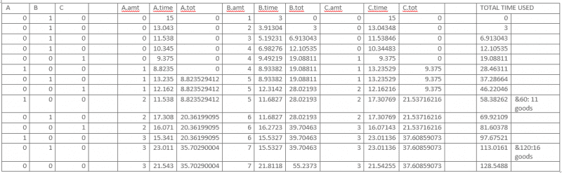

Okay, I've studied this problem for the last two days. I've come to two conclusions: The truly optimal solution requires brute-force search, due to the nature of trying to 'pack' the time-sizes into bins of 'hours' - that aspect of the problem is bin-packing. To write a optimal solver, I would encode the possible structure-orders as a trinary number - then it becomes a matter of generating all the trinary numbers up to a certain length, and their associated time-cost and goods-amount.
I think, however, that the greedy algorithm is a very close approximation to the optimal solution - That is, calculate the time-cost for each instance in the sequence, then take the structure which costs the least amount of time. This maximizes the number of structures, and should also nearly maximize the number of goods produced at the end of each hour. This is what I implemented in Excel:
I didn't clean it up at all. I also used minutes instead of hours. This situation is the specs you described, under two hours. It produces 27 goods.
The left 3 columns decide which structure is chosen for building every cycle. As you can see, it follows a certain pattern. Namely,
Build 4 Bs
Loop:
Build 1 C
Build 1 A
Build 1 B
Goto Loop
