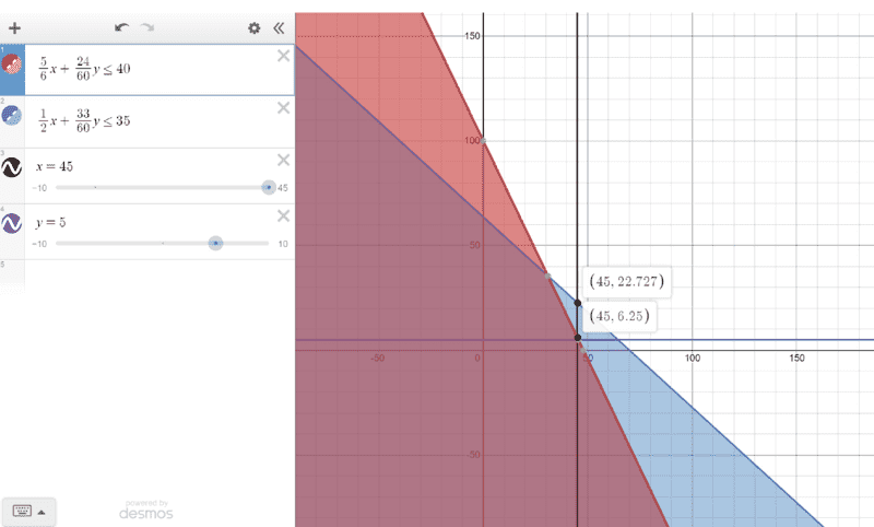

The initial steps were a bit confusing to me...i decided to use hours instead of minutes ...only then did it become more clear to me. See my graph,

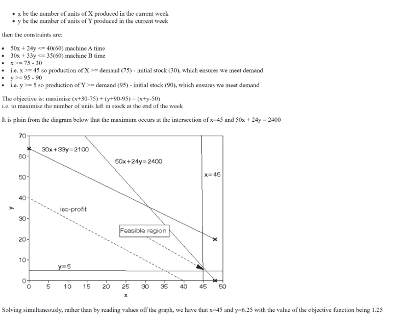

Ok i follow that the function would be optimised at ##x=45## and ##y=6.25## ...now to my question...we cannot have ##y=6.25## products...a product can only take natural numbers, ##1,2,3...##
I can follow that the objective function would be ##=1.25## this is clear...only on the part of ##y=6.25##.

There is no reason to expect integer-value answers
For example, exactly the same equations would apply if A and B were types of liquid with x and y representing the number of litres produced of each.
There is no reason why the optimal solution should give exact numbers of litres. In fact you would generally expect non-integer answers.
In your problem, as a final step, you might want to round-down to the nearest integer giving y=6 and the objective function = 1.
True I had fixated my thinking solely on solid products...its true that the products could be of liquid or gaseous form... implying that the solution given is correct.
