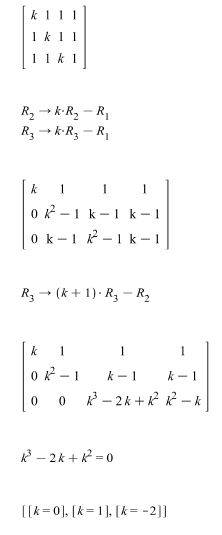

Hello
I have been trying to solve this system of equations, I need to find for which values of k the system has infinite number of solutions, no solution and a single solution.
I did some work, and found that for k=0 and k=1 there are infinite number of solutions and for k=-2 there is no solution.
However, for k=0 I ran this system on Maple and it found a single solution. What did I do wrong here ?
thank you !

You cannot set \(k^2+k-2=0\) since you then need an implicit division by zero to get a solution which is wrong since the last equation is \(0 \times x_3=0\) when \(k=0\)
CB
if I solve k^2+k−2=0 I get k=1,-2
where is the division by zero comes in ?
what is the solution then ?

Because you have already divided by 0.
You started out with a system of simultaneous equations \( {\bf{A}} (k) {\bf{x}} ={\bf{c}}\) to which you applies Gaussian elimination to the augmented system and that gave a last equation: \( (k^3+k^2-2k)x_3=k^2-k\) which leaves \(x_3\) undetermined when \(k=0\).
What you get when you set \(k^3+k^2-2k=0\) are the values of \(k\) for which either no solution exists or there are an infinity of solutions, if \(k^3+k^2-2k=0\) and \(k^2-k=0\) you have an infinity of solutions, if \(k^3+k^2-2k=0\) and \(k^2-k\ne 0\) you have no solutions.
Please look at your original post and clarify what question you think you are asking.

The unwanted "$k=0$" came in when you multiplied a row of the matrix by $k$, as for example in the row operation $R_2\to kR_2 - R_1.$ The row operation that is allowed in the Gaussian reduction process is to add a multiple of one row to another row. In this case that would allow the operation $R_2\to R_2-\frac1k R_1$, but not $R_2\to kR_2 - R_1.$ However, that goes wrong when $k=0$ because of the fraction $\frac1k.$ So you need to investigate the case $k=0$ separately to see whether or not the solution is unique in that case.
