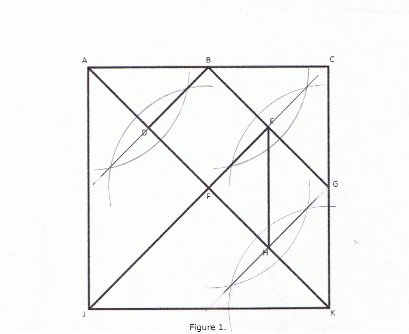

Here is the task:
Given:
● AFJ and JFK are large, congruent right isosceles triangles.
● EFH and ABD are small, congruent right isosceles triangles.
● BCG is a right isosceles triangle.
● BEFD is a square.
● EGKH is a parallelogram.
● ACKJ is a square with dimensions of 1 unit by 1 unit (i.e., the entire area of the square is 1 unit2).
Note: The right angle for each triangle can be determined by inspection. All line segments that appear straight are straight (e.g., JE ̅̅̅ is straight, with no bend at F).
There are no gaps or overlapping figures.
Requirements:
A. Determine the dimensions and area of each of the seven individual pieces from the square arrangement in Figure 1. (rearranging the pieces is not allowed).
1. Explain with full geometric justification, how you determined the dimensions of each piece.
Note: You cannot make midpoint assumptions (e.g., B is the midpoint between A and C).
B. Determine the angle measures of each of the seven individual pieces from the square arrangement in Figure 1. (rearranging the pieces is not allowed).
1. Explain with full geometric justification, how you determined the angle measures of each piece.
  • Geometry diagram labelled Figure 1 of a 1 by 1 square ACKJ with points A, B, C, D, E, F, G, H, J and K, divided into seven tangram pieces by thick line segments, with faint compass arcs drawn near points D, E and H.
Here is the work I have completed, the cells that mention the midpoint construction are the ones that are causing the problem I believe, but I cannot figure a different way to justify the lengths.
For▲AFJand ▲JFK
Statement
[TD="width: 50%"] Reason
[/TD]
[TD="width: 50%"] ▲ AFJ and ▲ JFK are congruent right isosceles triangles, AJ and JK have a length of 1 unit, m∠AFJ, m∠JFK and m∠AJK = 90°
[/TD]
[TD="width: 50%"] Given and visual observation
[/TD]
[TR]
[TD="width: 50%"] m∠AJF + m∠FAJ + m∠AFJ = m∠FJK + m∠FKJ +m∠JFK = 180°
[/TD]
[TD="width: 50%"] Sum of internal angles in triangle is 180°
[/TD]
[/TR]
[TR]
[TD="width: 50%"] m∠AJF + m∠FAJ = m∠FJK + m∠FKJ = 90°
[/TD]
[TD="width: 50%"] Subtraction
[/TD]
[/TR]
[TR]
[TD="width: 50%"] m∠AJF = m∠FAJ = 45°
[/TD]
[TD="width: 50%"] Division, Isosceles triangle definition
[/TD]
[/TR]
[TR]
[TD="width: 50%"] m∠AJF = m∠FAJ = m∠FJK = m∠FKJ = 45°
[/TD]
[TD="width: 50%"] CPCTC
[/TD]
[/TR]
[TR]

Solved: Since BEFD is a square and ABD is a right isosceles triangle, segments DB, BE, EF and FD are congruent. Since ABD is a right isosceles triangle AD is congruent with BD, therefore AD is congruent with FD and their sum is equal to AF. Since we now can mathematically calculate FD and AD we can solve the rest of the lengths without constructions.
