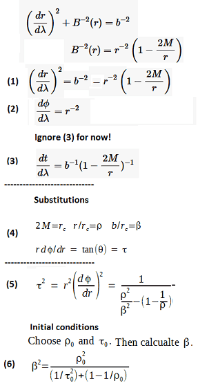

Hi @pervect:
I have been working with the equations you posted, and I have put them into a form that I expect will be easier for me to use. I plan to develop on a spreadsheet some graphs showing the relationship (based on initial conditions) between (a) radius and (b) the angle between trajectory and a radial line.
The equation forms are below. If you can spot any errors, I would much appreciate your posting me about them.

PeterDonis said:
We can't respond usefully to equations you post if we can't quote them, and we can't quote them if they're in an image.
Hi Peter:
I apologize for not reading about the LaTeX before this. After a quick perusal, It does not look any more confusing than the feature I use in LibreOffice. I will work on it, and I will re post my last post after I become somewhat comfortable with it.
Regards,
Buzz
Hi @pervect:
## (1) { } { } \left( \frac{dr}{d\lambda} \right)^2 = b^{-2} -r^{-2} \left(1-\frac{2M}{r} \right) ##
## (2) \frac{d\phi}{d\lambda} = r^{-2} ##
## (3) r^2\left( \frac{d\phi}{dr} \right)^2 = {b^{-2} -r^{-2} \left(1-\frac{2M}{r} \right)} ##
(1) and (2) are from post #5. (3) is r2 times the square of (2) divided by (1).
The following are some new variables I will substitute into (3) to simplify the expressions for my convenience.
## (4) \tau^2 = \tan^2 \theta = r^2\left( \frac{d\phi}{dr} \right)^2 ##
At radius r, θ is the angle between the trajectory of a light beam and the radial line.
## (5) r_s = 2 M \rho = r/r_s, \beta = b/r_s ##
## (6) 1/\tau^2 = {\frac {\rho_2} {\beta^2} - \left(1-\frac{1}{\rho} \right)} ##
(6) is from (3) and (4) with substitutions from (5).
This establishes an algebraic relationship between τ and ρ which depends on the variable β. The value of β is determined by the initial condition values for τ and ρ as shown in (7).
##(7) \beta^2 = \frac {\rho_{0}^{2}} {(1/\tau_{0}^{2}) + (1 - 1/\rho_0)}##
Regards,
Buzz

Hi @pervect:
Thank you for your post.
Your next to last equation on your post #12 directly converts to my (6) with the substitutions from my (4) and (5). My (7) derives from (6) by solving for β2.
When I complete my spreadsheet calculations, I will create some graphs for [ρ,θ] pairs for a variety of β values. After that I plan to do some numerical integration to develop some additional graphs for corresponding pairs [ρ,φ] and [x,y] which will be displayed as light trajectories. I expect there will be three kinds.
(a) From θ = 900 closest to ρ=1 (radius rs) for some φ=0, asymptotically to a radius ρ for some φ < 180o.
(b) Similar to (a) except the asymptotic radius with be for some φ > 180o. This means that the outward moving trajectory would cross the inward moving part of the same trajectory at least once.
(c) The inward part of the trajectory would cross ρ=1.
Please let me know if you would like me to post the graphs.
