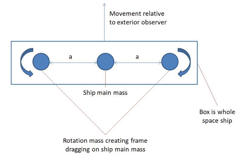

So... It is about a spaceship.
The setup is a spaceship with 2 rotating mass (opposite rotation) positioned left and right of the ship center.
The rotating mass inflict frame dragging around them so also on the ship, and they add at the center of the ship.
Inducing the frame to drag under the ship making it moving forward ?
To my understanding it convert angular momentum to linear momentum ?
And then it would propagate trough structural integrity.
Can this be called a reaction less drive ?
(as no matter/radiation is ejected or impacted to/from exterior)
  • Diagram of a box-shaped spaceship with two counter-rotating masses at left and right, each a distance a from a central ship main mass, with an arrow labelled movement relative to exterior observer pointing up.
They are separately conserved so you already know that something is wrong with this line of thought.
You aren't bringing the rotating masses along with the ship so you don't have a drive, you have an unusually complicated catapult.
No. Frame dragging does not induce any motion on objects at rest relative to the center of mass of the source. Or, more generally, on objects orbiting the source. Read up on Gravity Probe B, which detected the frame dragging due to the Earth's rotation: this did not change the orbits of the probe satellites at all, it only induced a precession in gyroscopes carried inside the satellites.

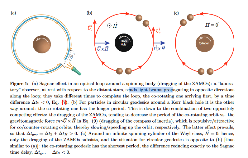

My apologies I am back again with what is supposedly a silly misunderstanding.
Based on the previously cited paper, figure 1.
And particularly the different time delay for light or a particle for a revolution in opposite direction around the rotating mass. (Sagnac effect)
Taking again the previous setup of spaceship with 2 opposite rotating mass and with the structural integrity to bring the mass with you.
So around each mass, you start with the cancelling action-reaction of synchronous emission in both opposite direction. Then at a full circle, you have the action-reaction from the light/particle arriving from direction n°1, and you have it sooner than from the opposite direction.
During this little time delay difference... The ship move forward right ?
And then stop when the light/particle arriving from direction n°2 arrive with its action/reaction to cancel it.
  • Three-panel diagram labeled (a), (b), (c) showing circular loops around a spinning body: (a) optical loop with light beams around a rotating mass, (b) orbits around a black hole with velocity vectors, (c) orbits around a spinning cylinder with H = 0.
This setup is not stable; the ship would need to be firing rockets to stay in between the two rotating masses. Your analysis assumes that the only force on the ship is the counter-rotating light pulses, but it's not.

So the co-rotating pulses arrive back at their start points sooner than the counter-rotating ones. This would induce the central mass to move forward, yes, but also induce the rotating masses and/or the optical guides to move backwards. The opposite happens when the counter-rotating pulses arrive. Thus your ship wouldn't move, just bend and straighten very slightly.
But this can't happen in the OP's scenario, because the OP specified that all of these things are held together--"mechanically maintained in position". They're not free bodies.
