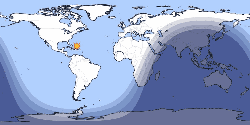

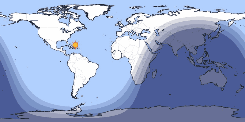

If I could see this as an animation, that might give a clue:
Alternately, I'm toying with breaking the problem down to as simple a schematic as possible and using only geometry. But it's still a 3 dimensional problem: 2 space dimensions and one time dimension.
