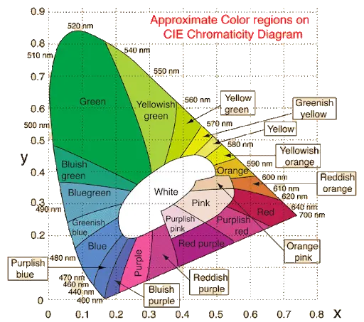

It doesn't- sunlight has maximum illuminance at 555nm (yellow).
Got a source handy for that? A quick google search doesn't give me good source.
Ha! First hit on my google search: https://www.agcled.com/blog/basic-information-of-the-visible-light.html
Although the chart lists 7 colors correctly, the text below it lists only 6 colors, with yellow, green, and orange transcribed incorrectly.
Just a guess.
The CIE chart could be a good source of the names of colours that we 'experience'. 555nm would appear (not very helpfully) to be seen as Yellowish Green.
so Everyone's right??? It's the green of fresh leaf growth.

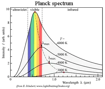

The reasoning above has one significant flaw. The point is that the Sun's spectrum peaks in the yellow-green part of the optical range only if intensity is defined per unit wavelength interval.
However, if intensity is defined per unit frequency interval (or per unit photon energy interval – it doesn't matter, as they are linearly related), then it turns out that the peak in the spectrum falls within the near-infrared range (corresponding to wavelengths of 900-1000 nm). These are distribution functions dependent on different variables, so this result is quite normal, although it may seem counterintuitive.
Since photosynthesis reactions ultimately involve individual photons, it's crucial that photons (with suitable energy) are more abundant, and this is achieved near the "frequency-based" intensity maximum. Therefore, leaves need to absorb primarily the near-infrared range, while their specific color in the optical range is more of a secondary consequence of their structure.
