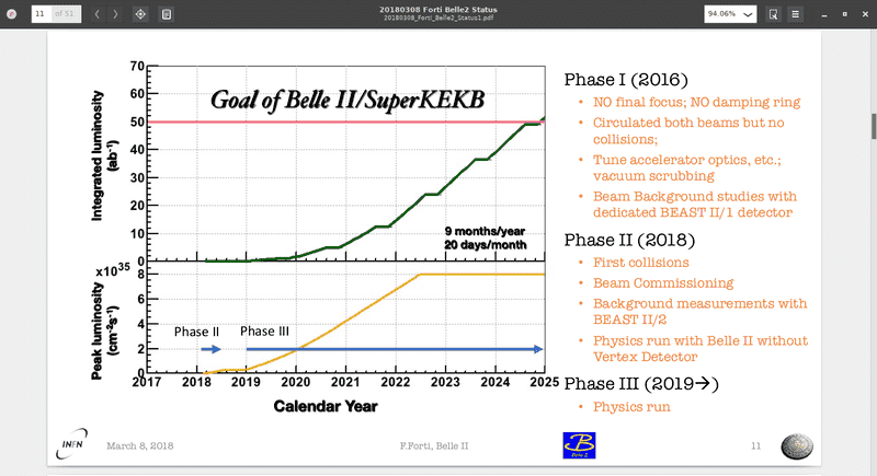

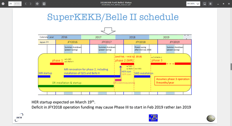

Some slides about the schedule and luminosity goals:
Slide titled SuperKEKB/Belle II schedule: a timeline of calendar years 2016 to 2019 and Japanese fiscal years, with bars for phase 1, phase 2 (MR), phase 3, DR installation and commissioning, and summer shutdowns.
Slide titled "Goal of Belle II/SuperKEKB" with two stacked plots against calendar year 2017 to 2025: integrated luminosity in ab-1 rising from near 0 toward a 50 ab-1 goal line, and peak luminosity in cm-2s-1 times 10^35 rising to about 8. Right side lists Phase I (2016), Phase II (2018) and Phase III (2019 onward) with bullet points.
Due to the climate in Japan, KEK has a summer shutdown (rather than winter), which will begin in the middle of July this year. It's usually earlier.

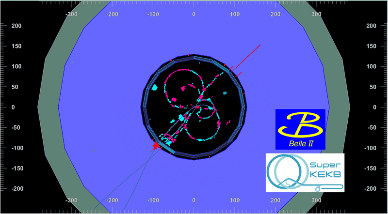

Collisions!
KEK news
Now the target will be to understand the detector better and to increase the collision rate in the next months. Belle (the previous experiment) collected a large dataset already, it will take a while to surpass this.
Event display from the image archive there:
Event display from the Belle II detector showing cyan and magenta particle tracks curving in a magnetic field inside a circular detector, with blue outer detector layers and labelled centimetre axes, plus Belle II and SuperKEKB logos.
  • Event display from the Belle II detector showing cyan and magenta particle tracks curving in a magnetic field inside a circular detector, with blue outer detector layers and labelled centimetre axes, plus Belle II and SuperKEKB logos.
