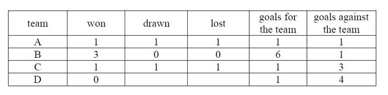

Each team has played once against every other team in a tournament. The results were collected in the partly incomplete table below. (see attachments)
a) Find the number of draws and the number of losses for team D.
b) What was the result of the match B against C?
a)
drawn 0, lost 3 ?
chawki said:
a)
drawn 0, lost 3 ?
Yes. Now what about part b?
this is really hard thinking...i need a good method to deal with these kind of questions :mad:
Nah, not really hard thinking, just process of elimination. :wink: Start with team A. It has a record of 1-1-1, and goals-for/goals against (GF-GA) of 1-1. Since B won all three games, A must have lost to B. Since A's GF-GA is only 1-1, it must have lost to B by a score of 0-1. Continuing from here, you should be able to figure out who beat whom, and by what scores.
