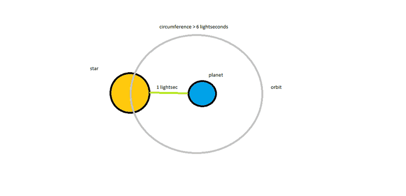

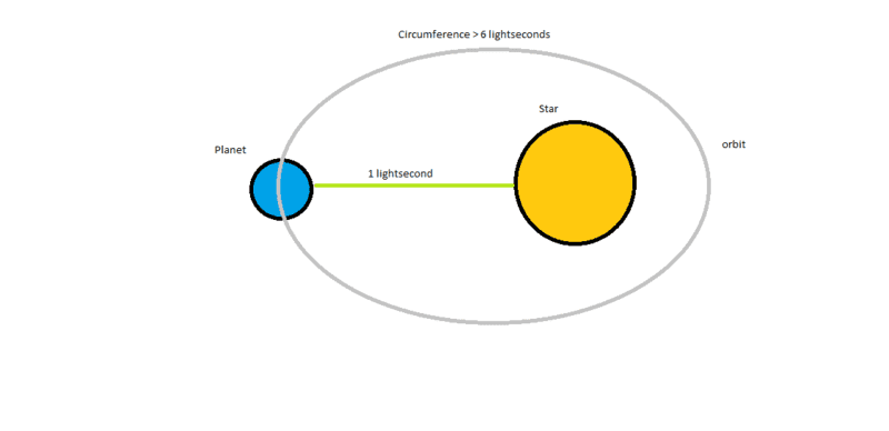

Star moves faster than light!
Cosnider a universe with only two objects, a planet and a star...
From the rest FoR of the Star, the planet appears to be revolving around the star.. And also the planet rotates in its own axis.. (just like our Earth and sun)...
The planet takes 1 second to complete a full rotation in its own axis (like 24 hours for earth)..
Please view the attached image files for better understanding...
Now from the rest FoR of the planet, the star appears to be revolving around the planet for every 1 second..(just like our sun appears to be revolving around the Earth in 24 hours)..
So from the rest frame of the planet, the star is actually moving at a speed six times faster than light(approx.) :confused:
How can this happen? what is wrong with this system?
Nothing is wrong with it. The rest frame of the planet is non inertial. It is only inertial frames where the speed of light is required to be c.

So what is the speed of light in non inertial frames?
There is no limit. It can be arbitrarily slower or faster than c (speed of light in vacuum in local inertial frame). Especially, coordinates built from a rotating frame can have many bizarre features in GR.

Try spinning around yourself and as you revolve, look at Andromeda galaxy up, in the skys: does it speed with warp 10? The two situation are not equivalent: inputing energy to rotate a human body is not the same as putting entire universe into a frenzy spin.
