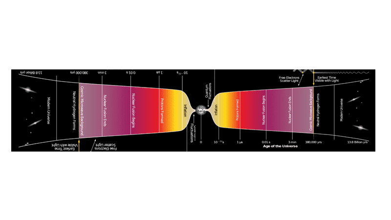

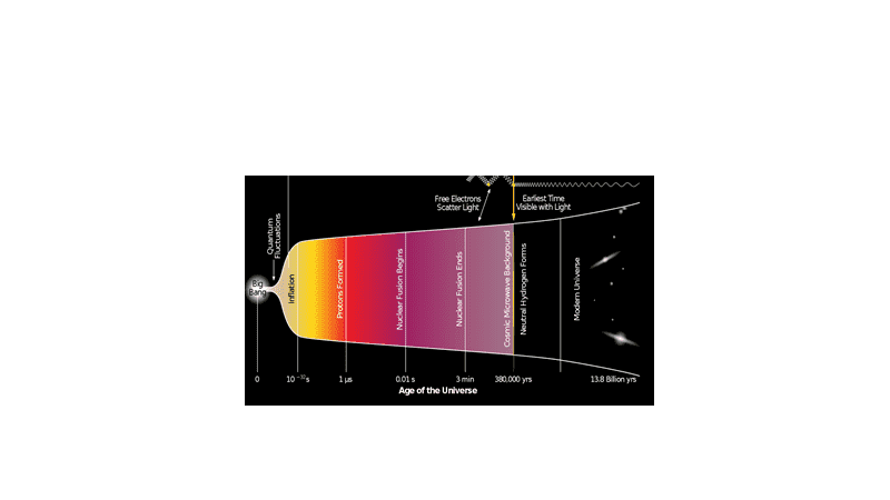

This is the common illustration of the history of the universe, but it gives the impression that the universe burst forth from the Big Bang like a garden hose on the spray setting. Is this accurate or just a simplification? Would a more accurate be the second illustration (also a simplification), and if it were, wouldn't this process occur spherically from the origin?
You misunderstand what this represents. It does NOT represent an expansion from a point in space, although that totally incorrect interpretation is not only common, it is promoted by pop-science presentations. About the most accurate way you can think of it is that it represents, inversely, the matter density of the universe.
The universe started off as a hot, dense plasma of unknown extent (probably infinite) and topology and expanded to where it is today.
Thank you, but then let me ask this another way. Did the expansion of the universe propagate spherically as in the balloon metaphor?
No, there IS NO sphere. Expansion happened everywhere at once. I know that is very hard to grasp. It's one of the things people have the most trouble with when learning actual cosmology instead of pop-sci presentations.
