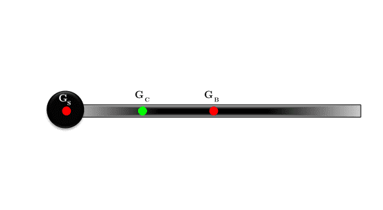

The problem consists of a bar of weight $W$ to which a sphere of also of weight $W$ is fitted at one end. The conbination is released from rest, with the bar horizontal. How will the combination fall if air resistance can be neglected?
##c.g. = c.m.## (in constant gravity)
244214
For convenience, I have marked the C.G. of the sphere as ##G_S## and that of the bar only as ##G_B##. The C.G. of the combination is halfway between them, shown by the green ##G_C##. My answer is that the combination will rotate about ##G_C## (centre of the bar) as it falls.
I wonder if I am right.

What would happen if the bar and the ball were separated and dropped independently?
Both would fall freely without rotating about their respective centers of gravity.
But, the ball faster than the bar?
No, both would fall identically, independently of their masses (i.e. even if the ball was heavier/lighter than the bar)
But, if you stick them together, then the ball falls faster?
No. If the ball fell faster, they would not remain stuck.
Or, the combination would rotate.
If the ball and the bar fell identically (even if their masses were unequal - Galileo's principle), they should fall the same way if they were glued. The tendency to rotate would exist if there was a torque on the system due to the combined weight. I don't understand how can that be.
Perhaps I misunderstood your OP. I thought you said that the system would rotate. (Presumable anti-clockwise in your diagram). In which case, the ball would hit the ground first.
I don't understand how the system can rotate unless one component is falling faster than another.
To give you a straight answer: the system will not rotate. There is no external torque on any free-falling object (symmetric or asymmetric) due to the force of gravity.

You were right - indeed I thought it wuld rotate (counterclockwise). Your careful questioning made me reconsider that.

Yes I suppose that's true. But if it is, imagine a rod inclined at ##60 ^{\circ}## to the vertical and then dropped. Would it fall as it is without rotating?
brotherbobby said:
Yes please do so and many thanks. I suppose we haven't had the last word on this. Rotational motion is far from straightforward.
Imagine any object in free fall. A sphere will do. All the force can be considered through the centre.
Look at the left edge of the sphere. There is a torque about this point of ##mgr##, where ##r## is the radius of the sphere. So, the sphere should rotate about the left edge?
But, look at the right edge. There is also a torque about that point, so the sphere should rotate about the right edge as well?
Of course, the sphere does not rotate as it falls, so how do you explain the torque?
Hint: when are Newton's laws not directly valid?
Yes. The acceleration due to gravity is equal for all points on a body.

True. One way to answer that is to see both the left and the right edges. Surely the sphere can't rotate both ways, which would explain that the sphere has to fall down straight without rotating.
But the other way you suggested is more interesting. Newton's (second) law is valid for an extended body only when we consider the net external force (##\Sigma \vec{F}##) and the resulting acceleration of the center of mass (##\vec{a}_{cm}##). As for its rotational analogue : ##\vec{\tau} = I_{cm} \vec\alpha##. There would be an angular acceleration only about the center of mass provided there was a torque acting on it. But gravity acts at the cm, and therefore fails to provide any torque about it.
Is this an instance where Newton's law is not generally valid?
The key point is that the ball is accelerating. So, the physical left edge provides an accelerating reference frame.
To use Newton's laws in an accelerating reference frame you need to add an additional "fictitious" or "inertial" force. It's this force that cancels out the apparent torque.
