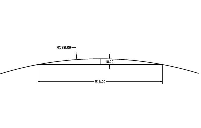

A screwy problem in basic trigonometry that I thought up.
A pitcher's mound is ten inches high and 18 feet in diameter. Suppose that this is a section of a ball. What is the radius of that ball?
Another way of looking at it is this. You have a large ball. Drill a hole in it ten inches deep. The bottom of the hole is part of a plane that is perpendicular to the shaft. The intersection of that plane with the surface of the ball is a circle with diameter 18 feet. What is the radius of the ball?
Consider a right triangle with legs of 108 inches and ten inches. The arc tangent is 5.29 degrees. So the radius of the sphere is 108"/sin(5.29) + 10" = 98.5 feet.

Graphically, the radius I obtain is 588.2 inches.

Isn't this simply a matter of solving for radius, given chord length and chord height?
I get the same answer as lbewkan lnewquan lebowski post 2.

You can also note that ##R-\sqrt{R^2-x^2}\approx x^2/2R## is the vertical drop at distance ##x## from the center. So ##R\approx x^2/2\Delta h## is 583", or about 48.6'.

Yes and this is a problem well known to those who grind ~spherical mirrors...... see Sagitta Theorem . Its not just for baseball!

I posted this because I wasn't sure my solution was correct, which it evidently wasn't. Trusting the Sagitta I get 588" = 48.6'. I should have done (108"/2)/sin(5.29 degrees)) = 48.8 feet. A good approximation.
