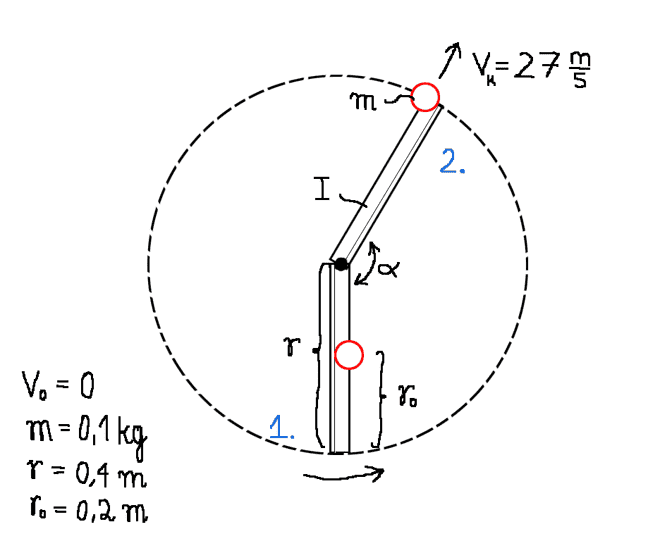

Hi! I need a help in desiging a target thrower. I can't find a force that is needed in order to throw a target with certain velocity. I assume that it's going to be a centrifugal force, but I can't find a connection with linear movement of target and rotation of an arm. Does anyone have an idea? Here's a picure:
Diagram of a rotating arm of length r with a mass m at its tip, starting at rest at position 1 and reaching position 2 at speed V_k = 27 m/s, with a dashed circular path and angle α marked at the pivot.
What is r0? I see it in the diagram, but what is it doing there? Is there more than one moving component?
r0 is a path, that disc has to travel, from it's initial position (V0=0), to the moment when it leaves the arm (V=27)

Yes, it is a clay launcher/thrower. It is spring-powered. I was thinking about the energy calculations, but I thought that it would leave the aspect of WHEN the target leaves the arm. I want it to leave, when the arm travels about 160°-170°. In energy equation I need also ω of the arm and that's the problem. I can't find proper ω of the arm.

Yes, exactly! I'm using that equation: E=1/2*(m*V^2 + Iω^2 + Iω^2). I know V and ω of disc, but I don't know how to calculate ω of the arm.

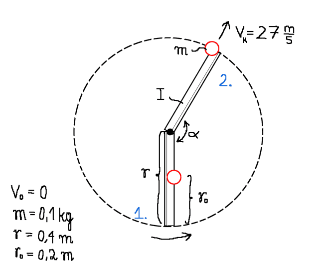

Well, maybe not full solution. The thing is I need to choose proper spring. I will do it from energy equation, just like You sugested. To do so, I need angular and linear velocity of clay target (which I have) and angular velocity of the arm. And that's the problem, how to calculate ω of the arm. I can't find connection between ω of arm and velocities of clay target. Not to mention, that the friction channel is complicating the case even more, because I don't have an idea how to take it to account neither.
Please Kamil, I don't understand well how the mechanism works. I was trying to know the mechanism at Internet, but I didn't find an scheme of it.If you draw the two positions, the initial and the final position, of the mechanism bars, I think it woul be possible to find out the relations you are looking for.

Thanks Dave, I was thinking in other system, and I see the sketch shows the two position.
Kamil, I have not found an easy solution: two second order nonlinear differential equations, which, of course, there would be possible to solve numericaly .
x is the distance target-center of the bar
v es the speed of the target which is the vectorial sum of the two ortogonal vectors: \dot{x} and \dot{α}.x
k is the spring constant
The two differential equations are:
(1). \ddot{α}.(I+m.x)=k.α
(2). \ddot{x}=\dotα2.xSorry i don't know how to write the equations properly. I'll try to solve it.
Whoa! Thank You guys for so many responces! I made some calculations and it came out, that ω of the arm equals 63,5 [rad/s]. Angle, for which target will leave arm, equals about 60°. You think these are pretty real results? Considering Dave's graph, I think that's a good angle.
