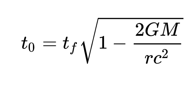

Actually the question is not really about the galaxies. But more about the time dilation in general. As another example we can take a planet.
To calculate the time dilation near the surface of the Earth we can use the equation:
For any radius "outside" the planet: M = total mass of the Earth.
But what mass must be considered to calculate the time dilation in the "middle of the Earth" or "near the center"?
Is it only the inner volume mass, like in the case of the gravitational force?
P.S. Let us consider that the density of the Earth is constant.

That's the same question that was asked in the link I gave. The reference there is to Wald, section 6.2 for the "interior" metric. It gets complicated, even for a perfect fluid.

The simple answer is no, it's not the same for gravitational time dilation.
The result you quote is the shell theorem for Newtonian gravity. And, where the Newtonian solution is a close approximation of the GR solution, it's logical that the shell theorem applies in GR as well.
Gravitational time dilation, however, is fairly negligible for these cases where the Newtonian approximation applies. The redshift from the surface of the Sun is very small and gravitational time dilation across the galaxy must be almost negligible. Moreover, the galaxy is not a sphere in the first place, so any calculation that is not simply a gross approximation is going to be difficult. The calculations you propose will be in that category of gross approximations.
If you want to go beyond this, then (as evidenced by the reference to Wald's GR book) an analytic solution for the metric inside a region of mass (whether that is the interior of a planet, star or galaxy) gets very complicated even for the simplest case of a perfect fluid.

Yes, but the only reason we can use that equation is because the Earth is roughly spherical and doesn't rotate much. That equation wouldn't hold for a disk galaxy.
