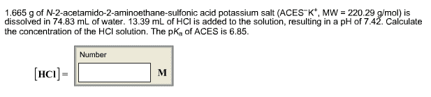

Homework problem text: 1.665 g of ACES potassium salt (MW = 220.29 g/mol) dissolved in 74.83 mL water, 13.39 mL HCl added, pH 7.42, pKa 6.85; calculate [HCl], with an answer box labeled Number and unit M.
