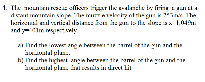

Typed homework problem about mountain rescue officers firing a gun at a distant slope: muzzle velocity 253 m/s, horizontal distance x = 1,049 m, vertical distance y = 401 m, with parts a) lowest angle to the horizontal and b) highest angle giving a direct hit.

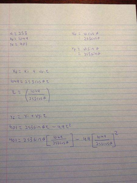

Handwritten kinematics derivation on lined paper: v_i = 253, x_f = 1049, y_f = 401; v_xi = v_i cos θ = 253 cos θ; v_yi = v_i sin θ = 253 sin θ; then x_f = x_i + v_xi t gives t = 1049 / (253 cos θ); then y_f = y_i + v_yi t − 4.9 t² with substitution for t.
The above is my attempt to solve question a), is this right approach? Now all i need to do is solve for theta? Or am i completely off track?
Also, i have no idea how to approach question b). some insight would be helpful... Thanks!
Yes, you have the correct approach. Yes, now solve for θ.
Solving (a) will help you see how to answer (b).
Looks like you're on the right track. Google trigonometric identities to figure out how to solve the quadratic. You'll get two angles as a solution.
