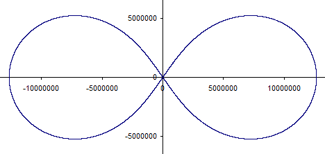

For what reason? The tidal forces wouldn't be sufficient. This is a rough estimation (with the gravitational field of corresponding point masses) for a contact system of two equal Earth-like planets:
There are strong deformations but the planets are far away from braking into pieces. Using the correct graviational field of the system would give a different result, but I have no doubt that the system would remain stable.

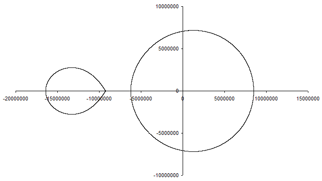

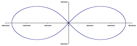

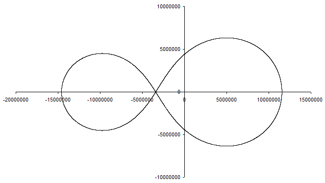

I don't think that it is so easy. During the mass transfer the radius of the small planet decreases faster than the radius of the large planet increases. In the result the matter bridge and therefore the mass transfer would be interrupted if the distance remains constant. With the increasing mass and therefore the increased gravity of the larger planet, the orbit of the smaller planet would become elliptical with a decreased periapsis distance if its orbital velocity remains constant. Due to the coriolis forces acting on the mass moving inside during the mass transfer the orbital velocity of the small planet will increase. I don't know which of these effects would dominate.
Edit:
I just repeated my calculation above with an Earth-like planet and another planet with half the mass. It appears that the system remains stable as long as the surfaces do not touch. This is the result for 1 km distance:
When they touch and the mass transfer starts, the system turns into this:
That seems to confirm that there is a runaway mass transfer if the planets touch and that it stops at a certain distance. However, this calculation is just a very rough estimation with many simplifications. A full simulation of the process would be much more complicate.
