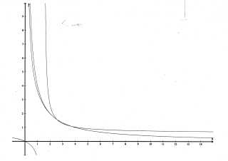

I can't afford more time on this now and got tired of it, so as much as I got is illustrated (for ε = 1 which is equivalent to making the vertical axis R) Horizontal axis is q.
I have not completely understood this system and give conclusions as far as I have got. The main space that gives three stationary points is that on the right part of this fig between the two curves - as q goes to infinity the bottom curve goes to 0 and the top curve goes to the R=0.638 you mentioned. I do not know a way to calculate this number mathematically and think it must have been calculated numerically, but id does correspond to something rational. I did manage to put mathematically a limit for R not be greater than for three sp's: 1/√2 = 0.707 which is not ridiculously far. The bottom curve on the right is the xy=4 we mentioned. I did also mention that this was an approximation; a more accurate curve is the outside curve on the left which is quite near the xy=4 curve, and as you see the difference on the right is insignificant.
The curves cross twice. I think there is a very thin sliver of conditions - the thin crescent between the curves, where there are three s.p.s too but this is no doubt of no practical significance. I think in all the rest of the space there is only one s.p.

What were your plots in mathematica to generate that graph? I would like to replicate it.
Thanks.
Thanks.
I think the forum rules and ethos rightly don't let me give you the formulae, at least without having seen more effort on your part. However one we already have.
You need first to work out a way to for how would you get that R = 0.638?
Nothing fancy. Crude. Just with graphs and a ruler for instance.
