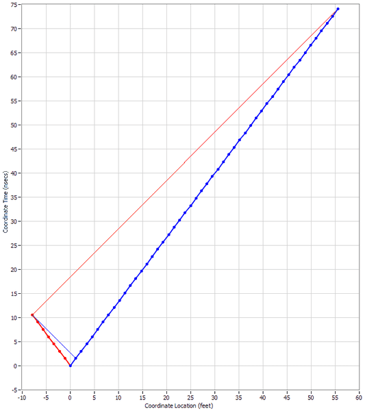

We start with a spacetime diagram to show Object A (in blue) moving at 0.75c to the right and Object B (in red) moving at -0.75c to the left. I hope you can identify their speeds by looking at the Coordinate Time of 10 nsecs and seeing that they each have moved 7.5 feet from their starting location. The dots represent one-nanosecond increments of time on their own clocks which is dilated (stretched out) compared to the Coordinate Time by the factor gamma. I am using the speed of light to be 1 foot per nanonsecond:
Spacetime diagram of two worldlines: a blue line from the origin rising to the right and a red line rising to the left, forming a V shape with time on the vertical axis in nsecs and coordinate location in feet on the horizontal axis.
Now in order for each Object to measure the speed of the other object relative to themselves, they have to measure its location at different times. They can start with the time when they are colocated and then measure the distance at some other time and dividing the distance by the time they can calculate the speed of the other Object:
Spacetime diagram with coordinate location in feet on the horizontal axis and coordinate time in nanoseconds on the vertical axis. A blue dotted worldline rises to the right and a red dotted worldline falls to the left, with light-like lines in thin blue and red drawn from the origin and the endpoints.
The way they measure the distance is by sending a radar signal at some point in time and measuring how long it takes for the reflection to return. Then they take the midpoint in time between the emission of the radar and its reception and establish that as the time of the measurement. They also take one-half of the time interval and calculate how far light travels during that amount of time and establish that as the distance.
So let's say that the blue Object sends out a radar signal at his time of 1 nsec. He gets the return signal at his time of 49 nsecs. (You'll have to count the dots to show this.) Since the time interval is 48 nsecs, he establishes the distance that light travels in 24 nsec which is 24 feet and he establishes the time of the measurement to be at the average of the two times or 25 nsec. This process is identical to Einstein's convention.
Now all he has to do is divide 24 feet by 25 nsec and get 0.96 feet per nsec as the measured speed of Object B relative to himself.

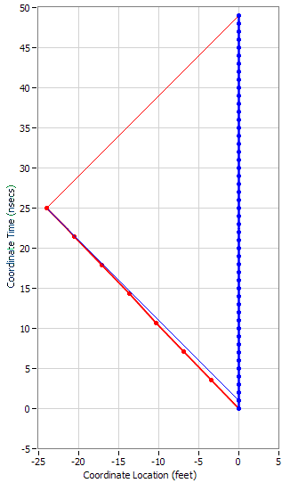

We can transform to the rest frame of the blue observer and we see that his measurements match what his rest frame shows:
Spacetime diagram with coordinate location in feet on the horizontal axis and coordinate time in nsecs on the vertical axis; a blue vertical line at location 0 and a red line sloping down-left from the origin to about -24 feet at 25 nsecs, with a thin black line forming a triangle back to the blue line at about 49 nsecs.

  • Spacetime diagram of two worldlines: a blue line rising to the right from the origin and a red line falling to the left, forming a V shape. Axes: Coordinate Location (feet) from -10 to 10, Coordinate Time (nsecs) from -5 to 15.
  • Spacetime diagram plotting coordinate location in feet against coordinate time in nanoseconds, with a blue worldline rising to the right and a red worldline falling to the left, both marked with dots at one-nanosecond intervals.

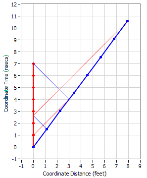

Sure, you can have object A move at 0.75c relative to object B as shown here:
Spacetime diagram with coordinate time in seconds on the vertical axis and coordinate distance in feet on the horizontal axis; a red vertical line marks a worldline at distance 0 from 0 to 7 seconds, and a blue line rises diagonally from the origin to about 10.5 seconds at 8 feet, with thin diagonal lines showing light signals between them.
Notice that both objects measure the speed of the other one the same way as I showed in my previous post, by sending out a radar signal at their own time of 1 nanosecond and then noting that they get the return signal at their own time of 7 nanoseconds. They then establish the time of the measurement to be the average of those two times or 4 nanoseconds and the distance to be how far light travels in one-half of the difference between those two times (3 nanoseconds) or 3 feet. And so they each measure the speed of the other one relative to themselves as 3 feet divided by 4 nanoseconds or 0.75 feet per nanosecond (0.75c).
I want to emphasize that they are applying Einstein's convention and second postulate, that light propagates at c in any Inertial Rest Frame (IRF). In other words, they are not, nor can they ever, measure the speed at which the light propagates away from or toward them. It's an applied definition.
Note that the measurement is also shown more directly by object B, since we did this in object B's rest frame but we can transform to object A's rest frame (0.6c from the first) to see how the measurements are more directly shown (in other words, applying Einstein's convention):

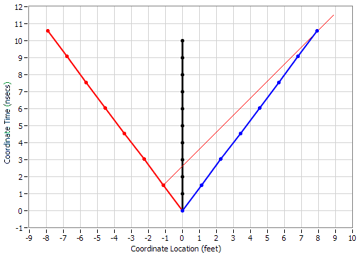

But we can also transform to any other IRF, such as the one in which both objects are traveling at the same speed (0.451416c) in opposite directions, like you wanted in your first post:
Spacetime diagram with coordinate distance in feet on the horizontal axis and coordinate time in nanoseconds on the vertical axis, showing two V-shaped worldlines from the origin with radar signal lines between them.

  • Spacetime diagram with coordinate time in nanoseconds on the vertical axis and coordinate distance in feet on the horizontal axis; a blue worldline and a red worldline run diagonally, with red and blue marked points and thin lines showing radar signal paths between them.
  • Spacetime diagram with coordinate distance in feet on the horizontal axis and coordinate time in nanoseconds on the vertical axis, showing two world lines forming a V shape with a blue line and a red line, plus thin radar signal lines crossing between them.

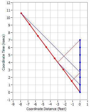

Ok, we'll add an observer as you described but keep in mind, he cannot observe what we observe in the diagram unless he also makes a lot of measurements and after the fact creates his own spacetime diagram which I will leave to you to figure out how he would do this. Here is a spacetime diagram (he is in black) showing what you asked for:
Spacetime diagram with coordinate location in feet on the horizontal axis and coordinate time in nsecs on the vertical axis; a vertical black line at location 0 marks a stationary observer, red and blue lines form a V from the origin showing two objects moving apart, and a thin diagonal line represents a light beam.
Note that the red object B sends a beam of light at its time of 1 nsec towards object A. The stationary observer will see this at his time of 2.645751 nsec and it will continue past him and object A will see it at its time of 7 nsec. These numbers are determined from the Relativistic Doppler factor. If you square the factor for the observer, you will get the factor for object A.
  • Spacetime diagram plotting coordinate time in nsecs against coordinate location in feet; a red line runs down-left to a vertex at the origin, a blue line rises up-right, and a black vertical line marks a stationary observer at location 0.

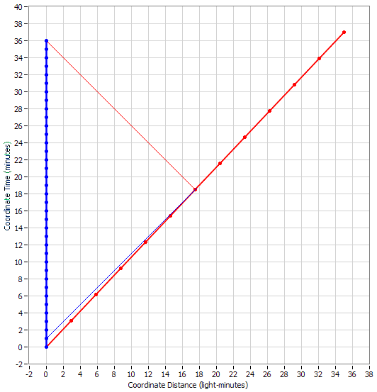

Just for the fun of it, I decided to try it with A going in the opposite direction as B and it too produces an integer relationship.
But to make the diagram more manageable, I had A send his radar signal at his time of 1 (we can multiply everything by 4 to see the effect at the Earth's frame at 5 minutes):
Spacetime diagram with coordinate time in minutes on the vertical axis and coordinate distance in light-minutes on the horizontal axis. A blue line runs from upper left down to near the origin, a red line runs from the origin up to the right, and a thin red line runs from upper left to the right at time 10.
A sends his signal at 1 minute and gets the return at 36 minutes so he establishes B's speed as 35/37 = 0.954954c (I left off the two divisions by 2 since they cancel out). And here is the diagram transformed to A's rest frame but with B's worldline extended:
Spacetime diagram in a frame where one worldline is vertical at x=0 from t=0 to t=36 and a second worldline runs diagonally up to x=35 at t=37; light rays drawn in red and a light signal reflects at about x=17.5, t=18.5.
It's easy to see that B passes through x=35 at t=37 and we can do the exact calculation as:
(0.6+0.8)/(1+0.6*0.8) = 1.4/1.48 = 0.7/0.74 = 3.5/3.7 = 35/37
  • Spacetime diagram in a single frame: coordinate time in minutes against coordinate distance in light-minutes. A blue vertical worldline sits at distance 0 from t=0 to t=36. A red worldline runs diagonally up to the right, reaching about distance 35 at t=37. A thin red light ray runs back from the red line to the blue line at about t=36.
