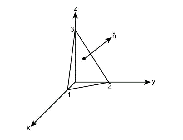

Use the cross product to find the components of the unit vector ˆn perpendicular to the shaded
plane in Fig. 1.11.

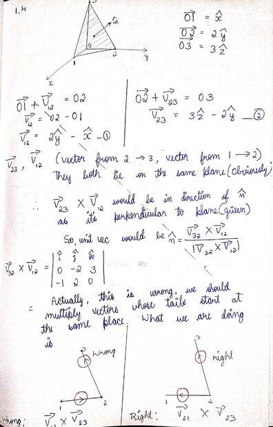

If you want the vector which represents the base from 1 to 2 (or O1 to O2 are the position vectors, I am using co-ordinates as names), what would O12 (vector from 1 to 2) and why?
1. Would it be O1 - O2 or O1 + O2? and why?
I got the wrong answer when I assumed O1 + O2, but I don't understand why? What's the difference?

For clarity I'm going to rename points 1 and 2 as points A and B, respectively, and O is the origin. By vector addition, OA + AB = OB, so AB = OB - OA.

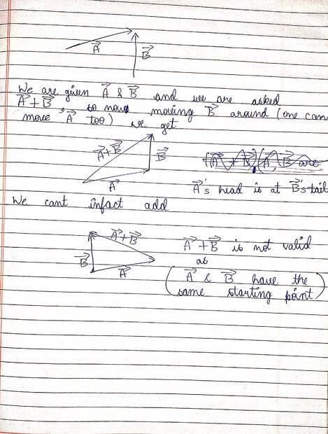

I understand what you are trying to say completely, but in purely a mathematical way, I can't add O1 and O2 because, it doesn't make much sense as in order to add two vectors the head of the first vector should be at the tail of the second vector or vice versa, am I right?
So, when I add vec(O1) and vec(O2), I am not getting vec(12), but rather I am getting a vector which would point to i + 2 j, which basically is like the middle point of those vectors (not really, but I lack the vocabulary to explain it). It makes sense now.also, I feel like I can also imagine this in a different way, a person can't travel in two directions simultaneously, so it doesn't make sense to add O1 and O2? Are my ways of interpreting this acceptable?

No, not right. You can move vectors around as long as the move is strictly a translation that preserves the direction and length of the vector.
Yes. At first I didn't pick up on vector O1 having its head at the point (1, 0) and similarly for vector O2. You can write these two vectors as <1, 0> and <0, 2>. Adding them would result in the vector <1, 2> or as you wrote it, i + 2j.

@Mark44 Thank you very much for that. But I kinda have a doubt regarding this. Even when you move vectors around, aren't you really bringing the vectors such that one vector's tail is at another's head?
If I am not articulate enough, this might aid what I am trying to say

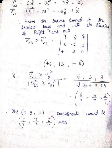

> BTW, which part of the answer in Griffith do you believe is wrong? At a quick scan of the page, the work there looks fine to me.
actually, they are slightly wrong, but I am pretty sure it's a calculation mistake. No solution is given in the book, it's just one of the exercises.DocScanner 07-Jun-2023 23-41_1(1).jpgDocScanner 07-Jun-2023 23-59.jpg
The answer should be 1/7*(6,3,2) as I have shown above, ignore the first page.
That's not really different from what I said. As long as you move them rigidly, it doesn't matter.
You're right, because their final vector isn't a unit vector. The vector <6, 3, 2> has a magnitude of ##\sqrt{49}##. I've gone through their work in detail, and can't find where they went wrong.
It's worse than "slightly wrong" -- they have made a pretty serious mistake, one that I'm surprised to see in a book as well-known as Griffith's.
What they did was to calculate unit vectors ##\hat{r_1}## and ##\hat{r_2}##, and then crossed them to get ##\frac 1 {\sqrt{50}}< 6, 3, 2>##. Their mistake is in thinking that the cross product of unit vectors is also a unit vector. This happens if and only if the vectors being crossed happen to be perpendicular to each other. For the problem in this thread, the vectors are not perpendicular (their dot product is nonzero), so the result of crossing the unit vectors above has the right direction but isn't a unit vector.
