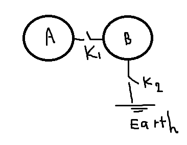

We have two similar conducting spheres. The charge of sphere b is equal to 30 and the charge of a is equal to -10 (In SI unit). We bring the plastic rod clos to sphere a. We close the k1 key and open it again. Then we close and open key 2. The final charge of two spheres?
Two ideas:
1) Negative charged object get close to A then we close K1 key. So -10SI charge from sphere A moves to sphere B and 30SI charge moves from sphere B to sphere A. At this moment sphere A has 30SI charge and sphere B has -10SI charge.
2) We close K1 key so system of 2 spheres should have ## 30-10=20##SI charge. But because of plastic rod that is close to sphere A all this 20SI charge moves to A and B doesn't have any charge.
I cannot find out which one is correct to continue ...

The problem refers to 'the plastic rod' but this has not been mentioned before and is not shown in the diagram. Is the question/diagram complete?
By the way, the SI unit of charge is the coulomb. If you have a charges of -10C and +30C on the spheres these are somewhat large charges. Expect something like this and complaints from your neighbours! Maybe you mean units of microcoulombs, ##\mu C##.

It only mentioned that we bring that negative charged plastic rod close to sphere A. So we can add it to the diagram if we want to ...

Is this a question that you found in a book or did you put it together yourself? I am asking because a numerical answer cannot be found without the amount of charge and its polarity on the plastic rod. Even then, it would be difficult to get numbers out without doing some kind of numerical computation.
That said, please explain why should charge move to and from conductors and the Earth? When such flow is occurring, what must be true for it to stop?

When we close K1 key because of that negative charged rod the negative charges on sphere A want to get away from the rod so they move to the furthest point sphere B.
If we assume only negative charges move:
In this case, only 10 microcoulombs of negative charge will go from A to B, so A will be neutral and B will have a charge of 10-30=20 microcoulombs.
I think this is better that my first two ideas ...

It doesn't work like that. Only some of A's negative charge would move to B. Exactly how much would depend on the charge (amount and distribution) on the rod. Even if you knew this, it would be a complex calculation (as already noted by @kuruman).

You can answer this question with numbers if you get rid of the charged rod. Just close and open K1 and then close and open K2. How much charge would be on each conductor then?

I'm not sure it's that simple.
Closing and opening K1 will leave 10##\mu C## on each sphere.
Then closing K2 then grounds sphere B, making its potential zero. But I believe that does not leave a zero charge on B. There will be an induced 'mirror' charge on B so that B is at ground potential in the presence of A's field. Finding the size/distribution of the mirror charge on B is not trivial.
Finally, opening K2 will have no further effect.

For information...
An example: you put a point charge, +q, a distance d in front of an infinite conducting plane. The resulting field behaves as if there were no plane, but just two charges, +q and its reflection (-q) separated by 2d.
Of course, the -q charge doesn't exist. The resulting field is actually the sum of the fields from the +q charge and from induced negative surface charges on the conducting plane.

You don't need to know about mirror charges. At the end of the procedure that I described in post #11 the charge on conductor B will be the same as in the following procedure:
1. You open both switches.
2. You put ##10~\mu\text{C}## on conductor A
3. You close K2.
Do you see now why there will be charge on B?

You can't because of the proximity of charged sphere A. Electrons from the Earth will be attracted and flow into sphere B. That's the first step in charging by induction.

To answer your question I would say that if sphere A has charge of Q then sphere B should have charge of -Q.
I was wrong (or at least misleading) when in Post #14 I said “Finding the size … of the mirror charge on B is not trivial.”
It is trivial in ideal circumstances.
In the ideal case, the only charge-carrying objects in the neighbourhood are A and B. We can neglect the charge-carrying ability of the ground itself by assuming that the dimensions of A and B, and their separation, are very small compared to the distance to the ground.
Every field-line must start and end on a charge.
In this situation, every field line leaving A must end on B - there's nowhere else for the field line to go. It follows that the induced ('mirror') charge on B is equal and opposite to A's charge.
So under ideal conditions, B’s final charge is -10##\mu C##.

You don't need to connect the spheres. In the simplest model for a conductor electrons are free to move inside it in response to external electric fields. A has lost electrons and has therefore net positive charge while B has zero net charge. Charged conductor A creates an electric field through B that causes some of the free electrons in B to redistribute themselves so that the electric field inside B is zero. A must be infinitely far away from B in order not to have an effect on it.
The presence of positively-charged A raises the electrostatic potential in its vicinity. The Earth is at zero potential by definition. This means that there is a potential difference between B and the Earth. When B is connected electrically to the Earth by closing K2, B becomes an extension of the Earth and must also be at zero potential. Negatively-charged electrons will flow from the Earth to B until its potential is lowered to zero. This will change the net charge on B from zero to negative. When K2 is reopened, the negative charges are trapped on B. We say that the originally neutral B has be charged by induction to carry net negative charge.

True, but this doesn't imply that all the lines leaving A will end at B. Lines leaving A can also end at charges at infinity or charges induced on the surface of the Earth which is part of the picture.

Can't we find the amount of charge as I said in post #21?
For the ideal case (Post #22) all field lines leaving A will necessarily end on B.
But I agree with you that in a real-world situation, this will not be the case due to induced charges on remote objects and on the earth itself.
