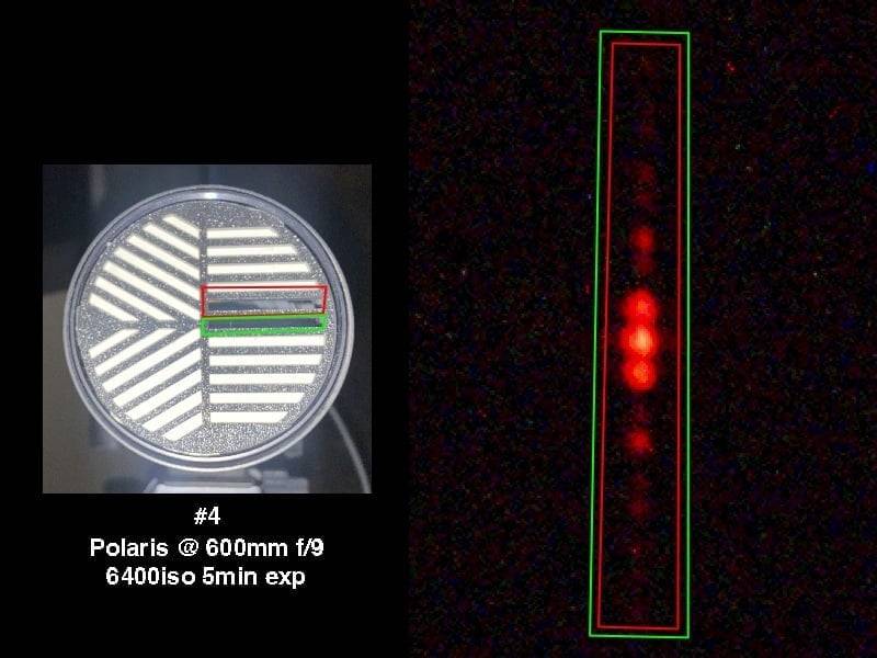

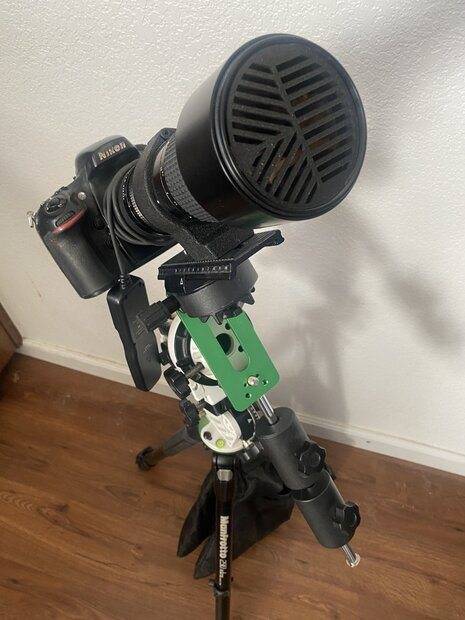

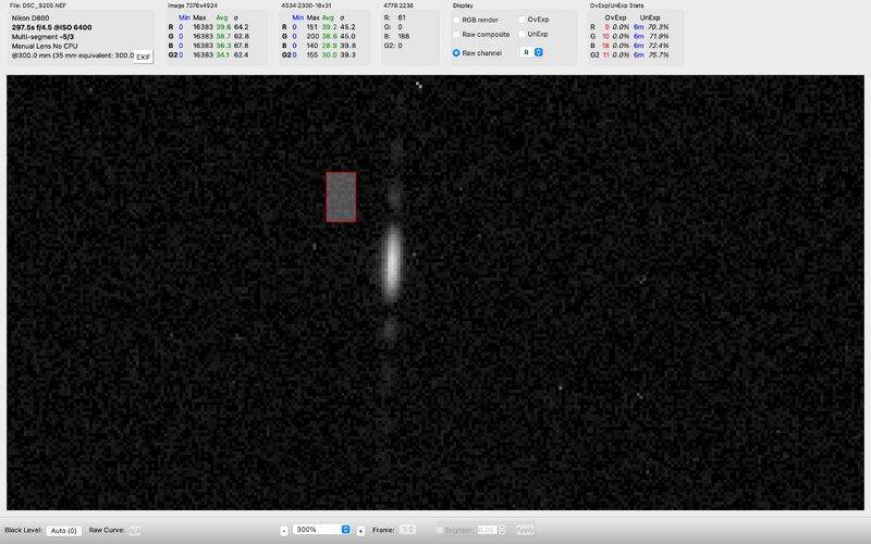

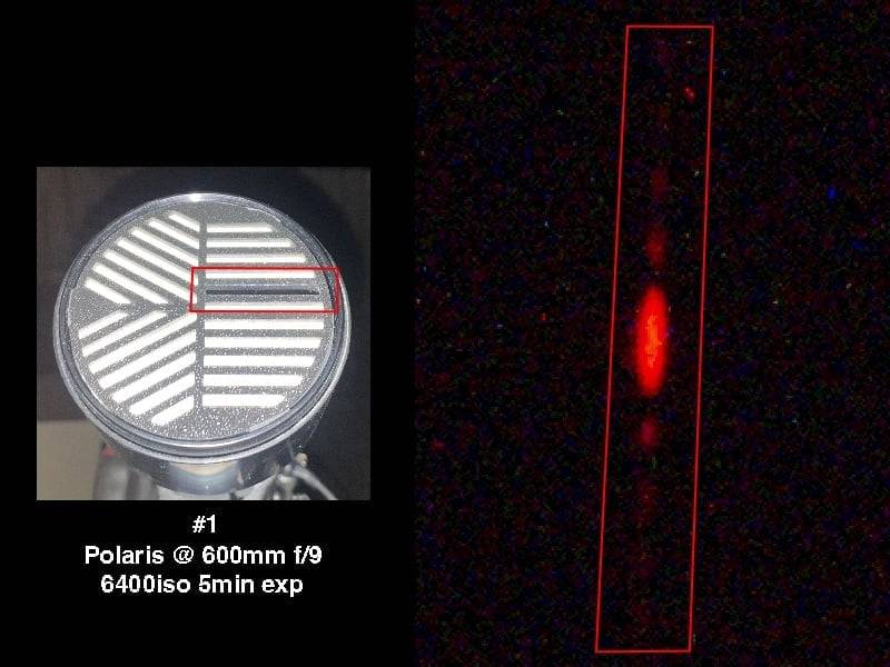

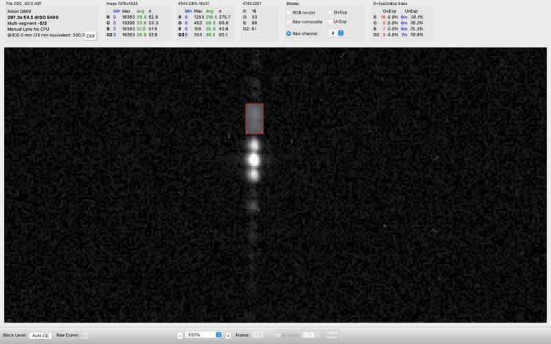

Isn’t all starlight coherent? My understanding is to get destructive interference the light has to be coherent. If you view a star through a double slit and narrowband filter you can observe destructive interference, like these pictures I took...
https://www.physicsforums.com/threads/destructive-interference.1048058/
What’s interesting is I still measured almost exactly twice as many photons with the double slit as the single slit despite the presence of destructive interference (within 1%)…
Devin-M's measurements:
https://u.pcloud.link/publink/show?code=kZcjE2VZR1eBfOCgGAYfuGOv9EMgPH3KIR07
(Images 9205 & 9213)
Single Noise R Avg 39.2
Single Light R Avg 128.8
128.8 - 39.2 = 89.6
Double Noise R Avg 37.1
Double Light R Avg 218.5
218.5-37.1 = 181.4
181.4 / 89.6 = 2.02x higher

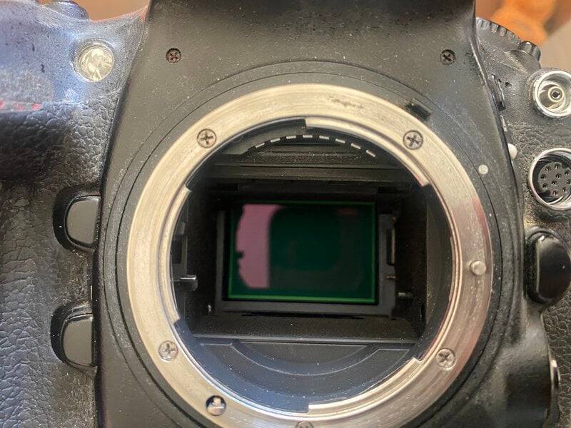

My setup used a narrowband Hydrogen Alpha filter to only let 1 wavelength hit the sensor (656nm).
