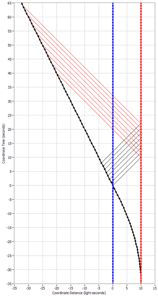

Here are some spacetime diagrams depicting your scenario. Alice is shown as the thick blue line and her radio emissions are shown as the thin blue lines. Rather than show a million such lines per second, I show only one which is enough to illustrate the Doppler relationships. Planet Z is shown as the thick red line and the return signals off its reflector are shown as the thin red lines. Bob is shown as the thick black line starting at the bottom on planet Z and accelerating to the left toward Alice (blue). Before he gets to her, he has achieved a speed of 0.5 c in the mutual rest frame of Alice and planet Z. When he gets to her, they both start emitting their signals toward the reflector on planet Z. Bob's signals are shown as the thin black lines. The dots mark off one-second intervals of Proper Time for each object/observer.
First is the rest frame of Alice showing her radio emissions and its reflections:
She receives the reflected signal at the same rate that she sent it but Bob receives ten seconds worth of signal in about 17.4 seconds which is a Doppler ratio of 0.57. This conforms to the theoretical value for a speed of 0.5c.

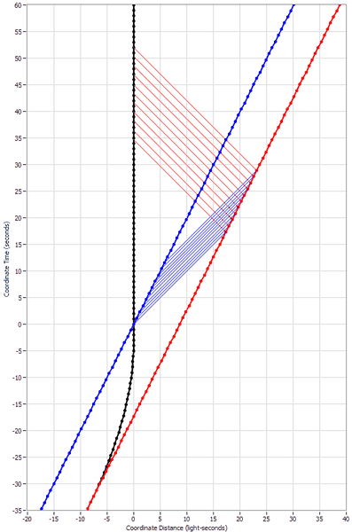

Second is the rest frame of Alice showing Bob's radio emissions and its reflections:
I show 7 seconds of Bob's signals being received on planet Z in 13 seconds which is approximately the same Doppler ratio of 0.54 that Bob received Alice's signals. But then they get Doppler shifted by the same amount again going from planet Z to Bob so that he receives the 7 seconds of signals in about 20.7 seconds for a Doppler ratio of 0.34 which is close to the theoretical value of 0.33.

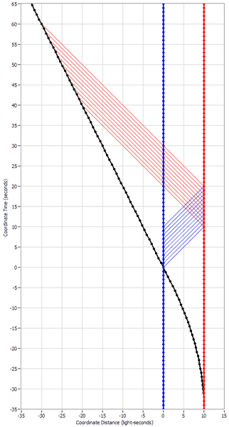

Third is the same as the first diagram but Lorentz Transformed to the rest frame of Bob after his acceleration:
Note that the same Doppler relationships are indicated in this diagram, showing that Doppler ratios are frame invariant.

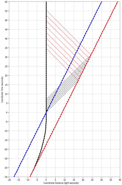

Finally, we have the second diagram transformed to the Bob's rest frame after he accelerates:
Again, we see that the Doppler ratios are the same as in the second diagram.
