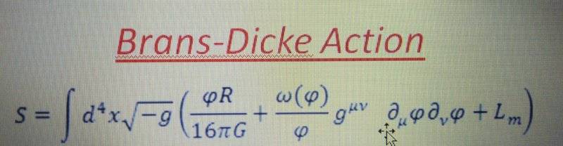

The brans-dicke action is
We have R which contains second order derivative in space and time of the metric components and product of first order derivatives in space and time of the metric components .
The second term in the figure also contains product of first order derivatives in space and time of the scaler field Φ(x,t).
To make it dimensionally consistent if we consider that the metric components gij vary over space, but how can be it is a function of time??
It is only if the space is curved for which locally the metric components gij doesn't vary locally but on a large scale (globally)on the manifold it varies (e.g gij(x) and if the space is expanding e.g gij(t) .
Is it so??

So there is a Φ related to R the first term and ω(Φ)/Φ related to the 2nd term ,now how these two terms are matched dimensionally since R and ∂μΦ∂μΦ(in figure) are matched dimensionally
##R## and ##\partial_\mu \varphi \partial_\mu \varphi## aren't matched dimensionally; they don't have the same units. The things that have the same units are
\varphi R
and
\frac{\omega(\varphi)}{\varphi} g^{\mu \nu} \partial_\mu \varphi \partial_\nu \varphi
Each term must have units of length to the inverse fourth power (because the integrand as a whole must be dimensionless, and it multiplies each term by ##d^4 x##). We know ##R## has units of inverse length squared. That means ##\varphi## must also have units of inverse length squared. (Note that these are not the usual units for a scalar field.) Each derivative has units of inverse length, so ##\partial_\mu \varphi \partial_\nu \varphi## has units of length to the inverse sixth power, which is not the same as the units of ##R##. This also tells us that ##\omega(\varphi)## must be dimensionless (since ##g^{\mu \nu}## is dimensionless and the factor of ##\varphi## in the denominator of the factor in front of the second term makes the units for that term as a whole work out).

If so then how is the dimension in Einstein -hilbert action matched
∫R√|g|d4x??
Implies R has units of inverse length to power 4
Because you left out the factor of ##1 / 16 \pi G##, which has dimensions of inverse length squared in the Einstein-Hilbert action. (Note that I specifically commented about how ##G## must have different units than it usually does in the version of the Brans-Dicke action that you wrote down.)
