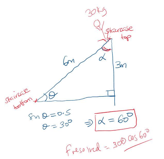

In my approach, i have
##F_{Resolved} = 300 \cos 60^{\circ} = 150## Newtons.
I also have,
... from ##v=u +at##
##2=0 +6a##
##a= \dfrac{1}{3}##.
##F=ma##
##F=30 ×\dfrac{1}{3} = 10## Newtons
Therefore,
##P= \dfrac{(150+10) ×6}{6} = 160 ## W
Insight is welcome. Thanks.
What force are you calculating, and where does that angle come from?

I used this approach,
I ask again, where do you get that angle from?
It is not given in the question, and neither is the distance of 6m.
And you have not answered my question about the force. What forces act on the boy? What is the net force? How does that relate to the acceleration?
I'll give you a hint: forces are not the way to solve the question. What else can you try?
I used ##s=ut + \dfrac{1}{2}at^2## to determine the hypotenuse distance... with the vertical height given i was able to determine the angle as indicated. Looks like this was wrong? The forces are weight acting downwards, there is also the normal contact force which acts perpendicularly to direction of motion, therefore no work done and thus will not be considered...and the force acting along the slope which i was able to use ##F=ma## to analyse that.
You are not given s or a, so I do not see how you could have found either.

... so the ascent is vertical and not an incline- i did not seem to get that right.
No, stairs are not vertical. The climb is at an angle but why do you think that matters?
If a man carries 100 lbs over a total vertical distance of 10 feet, is the work done different depending on whether he does this across 10 feet horizontally or 100 feet horizontally?
