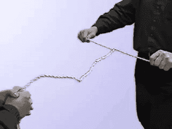

Two hands at opposite ends of a rope that has been untwisted, forming a tangled loop with kinks and supercoils in the middle.
As shown in the image the ropes develop supercoils on being unwound.
The knots caused due to untwisting develops tension enough to make it impossible to uncoil the rope further.
My question is :
What causes such unwanted stress(called torisonal stress maybe) and these knots?
Why does it happen only with coiled strands of rope?
All research has failed at providing the right solution to this problem(or even an incentive)
I would guess that in untwisting the rope you are adding twist to the individual strands. I bet it doesn't happen if you comb it, i.e. allow the individual strands to twist freely.
It looks to me like the original twist in the rope is in the opposite direction from the larger twist shown.

Twisted fibre type ropes usually have three smaller twines (fibres twisted together) combined by twisting in the opposite direction - the smaller twines are initially overtwisted whilst under tension so that they provide a counter force that will wind the three together.
The finished rope has a balance of torsion between the twisting of fibres within each twine one way and the twisting of the three twines in the opposite direction.
Separate those twines and you unbalance the combined torsion that hold the rope together - you will be returning overtwining to the individual twines. When the torsion in one direction is stronger than the other (and it isn't held straight with strong tension) the individual twines will act a bit like what DNA does and coil around itself.
Yes, I agree with #4. An ordinary rope often has three strands, which are the bunches of fibres, and which are twisted around each other. The lay of the rope is the direction of twisting. If the strands are themselves twisted one way and are then twisted around each other the opposite way this called regular lay and is the usual one seen. If they go the same way it is called Lang's lay. Lang's lay will not self lock and will tend to come undone.
If DNA is made of strands that are not initially twisted, then when the strands are twisted round each other they will each acquire a twist in the same direction as the lay. This is "Lang's lay". Then if the strands are taken apart without allowing untwisting, they will each, if not kept under tension, coil around themselves forming a side shoot.
