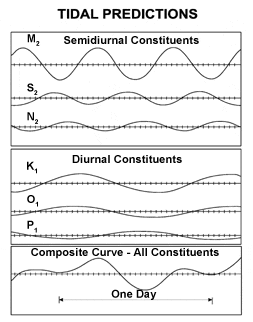

Then each day, there will be two high tides due to the moon and, in addition, there will be two lower high tides due to the sun at a different phase. But we only observe about two high tides and two low tides each 24 hours.
That's not how you add up amplitudes. The wiki article explains this comprehensively, with animations and graphs. I'm not sure what more you'd like us to tell you to make it understandable other than to point to places in the article.
This is how various components add up:
As you can see in this example, despite six components in total, of different phases, amplitudes, and periods, the end result is still two high and two low.
This animation shows how the two principal components (solar and lunar) add up visually:

I stand corrected.
Bandersnatch thanks so much for the detailed explanation. I fully understand now how to add wave shapes to get the result of only two high and two low tides of varying amplitudes.
