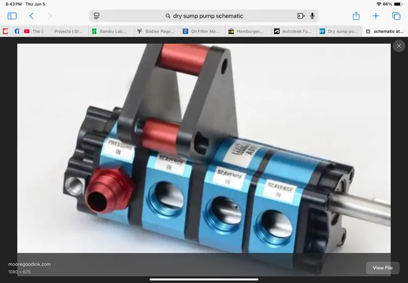

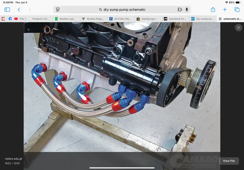

Baluncure, Below are the best examples I can find of the system I am dealing with in my query. Do these help?
Baluncore, First picture is schematic. Second is a duplicate I couldn’t get rid of. Third is a picture of typical pump construction. The forth and fifth show actual examples of connections. Mine are very similar. The difference is location of the return fitting on the pump and height of fittings on the oil pan. The scavenge out on my pump is located as in the 1st picture on the forward most section/stage of the pumps scavenge sections/stages. The scavenge stages are best viewed in pic 4. The difference is the fitting on the oil pan that connects to the forward most section/stage is elevated about 1/2 to 3/4 inches above the other two pan fittings. It means that section/stage might not be sucking as much or any oil as the pump begins operation thus the other two stages are overloading the output side of that section/stage. Could that hydrolock the pump. Thanks again

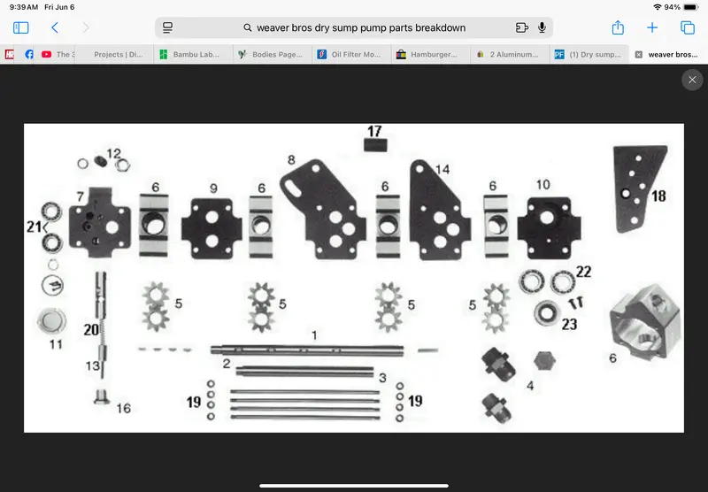

Lnewqban, I have attached a breakdown picture of the typical pump. In the picture item 1 is the drive shaft, item 2 the counter shaft. The Item fives are the gears, item 6 the pump body section. The right most three item 6 sections are the scavenge sections. They are separated by items 8 and 14. The two large vertical holes in the center of theses plates are where items 1 and 2 pass through. The third large hole offset right is the connecting passage between the sections of the pump. Does this help explain the operation?
