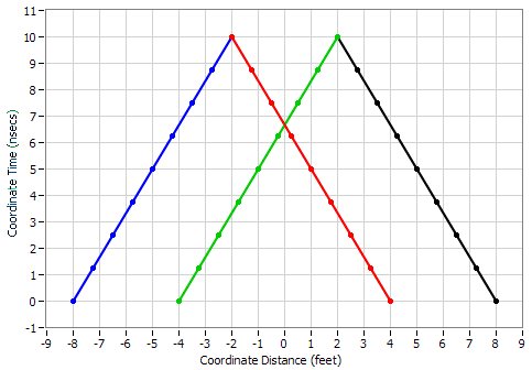

Let's assume in the symmetrical frame where both warriors are approaching each other that their speeds are 0.6c and that they have lances that are 5 feet long in their own rest frames. Since gamma at 0.6c is 1.25, this means their lances are Length Contracted to 4 feet in the symmetrical frame. In the following spacetime diagrams, I show the warrior on the left in blue with the tip of his lance in green and the warrior on the right in black with the tip of his lance in red:
As they approach each other, their tips pass at the Coordinate Time of 6.7 nanoseconds and then each tip simultaneously contacts the other warrior at the Coordinate Time of 10 nanoseconds. At this point we should consider each lance as a projectile because it will take a very long time for the shock waves to propagate through the lances and through the warriors and we would need more information to adequately show any more details on the diagram. Suffice it to say that the battle is a draw.

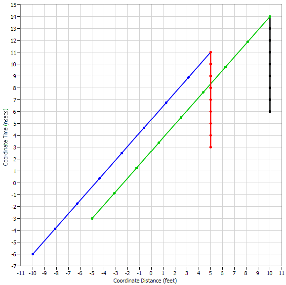

Now if we transform to the rest frame of the blue warrior, we see that his lance is 5 feet long while his opponent's is less than 2.5 feet long:
The tips pass at the Coordinate Time of 8.3 nsecs and a short time later at 11 nsecs, the blue warrior's lance contacts the black warrior. However, since the black warrior's lance is a projectile, its tip contacts the blue warrior 3 nsecs later and we see that it is again a draw.

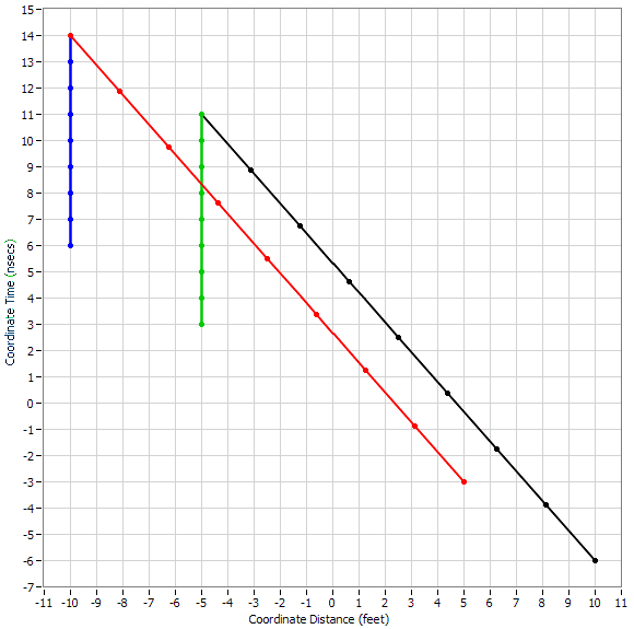

We can transform to the rest frame of the black warrior and see that everything has flipped:
