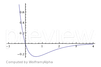

Suppose we want to solve y = 9-x - 3-x for x.
Let F(x) = 9-x - 3-x.
F is not 1 to 1. It has a minimum of -1/4 at x = log3(2) .
Now to solve y = 9-x - 3-x for x:
Let t = 3-x. Substituting that into the equation for y gives:
t2 - t = y .
Add 1/4 to both sides to complete the square giving:
(t - 1/2)2 = y + 1/4
Solving for t gives us:
[itex]\displaystyle t=\frac{1}{2}\pm\sqrt{y+\frac{1}{4}}[/itex]
Since x = -log3(t), our solution is:
[itex]\displaystyle x=-\log_{\,3}\left(\frac{1}{2}\pm\sqrt{y+\frac{1}{4}} \right)[/itex]
If we restrict the domain of F to x ≤ log3(2), then F-1(x) is the result with the minus sign.
[itex]\displaystyle F^{-1}(y)=-\log_{\,3}\left(\frac{1}{2}-\sqrt{y+\frac{1}{4}} \right)[/itex]
This is valid for any y such that y ≥ -1/4 .
On the other hand, if we restrict the domain of F to x ≥ log3(2), then F-1(x) is the result with the plus sign.
[itex]\displaystyle F^{-1}(y)=-\log_{\,3}\left(\frac{1}{2}+\sqrt{y+\frac{1}{4}} \right)[/itex]
This is valid for any y such that -1/4 ≤ y < 0 .​
Here is a graph of F(x) = 9-x - 3-x as given by WolframAlpha.
