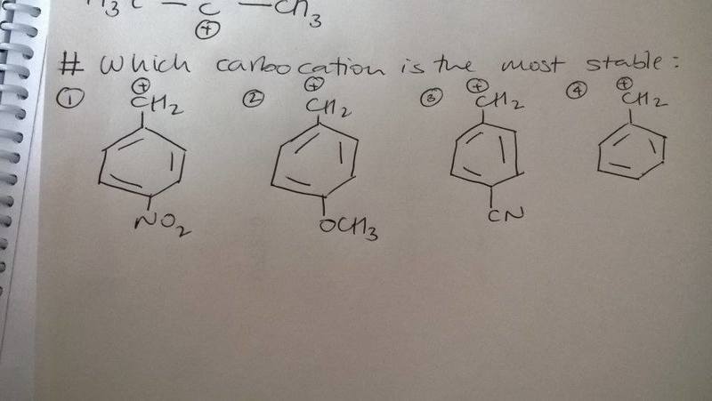

Shouldn't the answer be 4?
It certainly isn't 1 or 3 because they have maximum -I effect
How did you conclude it was 4 after you narrowed it down to 2 and 4?
OCH3 is an electron withdrawing group. So it will result in -R effect, making it less stable. Which leaves only option 4.
OCH3 is -R? Are you sure
I think you're confusing it with -I
Oh, right. It has a +R effect, so more stable. Thank you!
