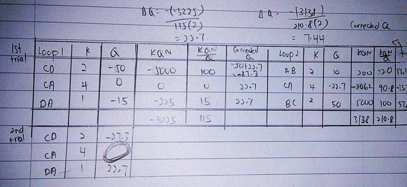

i have a netwrok of pipe as shown in the figure . I'm asked to find the flow rate using HARDY CROSS method . in the second trial of first loop at junction CA , which value should i use ? -15.3 from the corrected in second loop ? or 22.7 from the corrected value in the first loop ?
Handwritten pipe network diagram of a rectangular loop with corners A, B, C, D, flow arrows and K values on each pipe, with flows of 25, 35, 40 and 100 cubic metres per second marked at the junctions and loop labels 100p1, 100p2 and 15, 50, 50.
i think we should use 22.7 from the corrected value in the first loop ? am i right ?
  • Handwritten Hardy Cross iteration table on lined paper with loop columns for pipe flow corrections, showing first and second trial rows for CD, CA and DA, with circled 22.7 in the second trial CA row.
