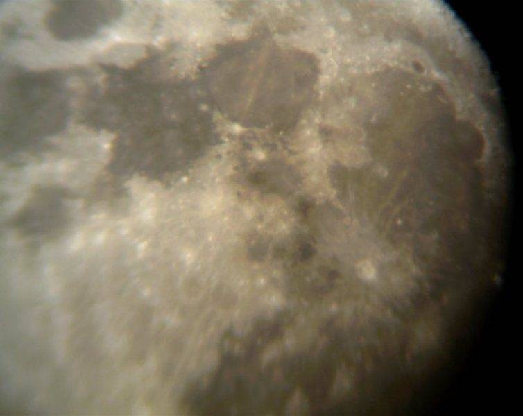

This is an image I took with the reflector. With or without the camera it looked the same. Almost like a double image.

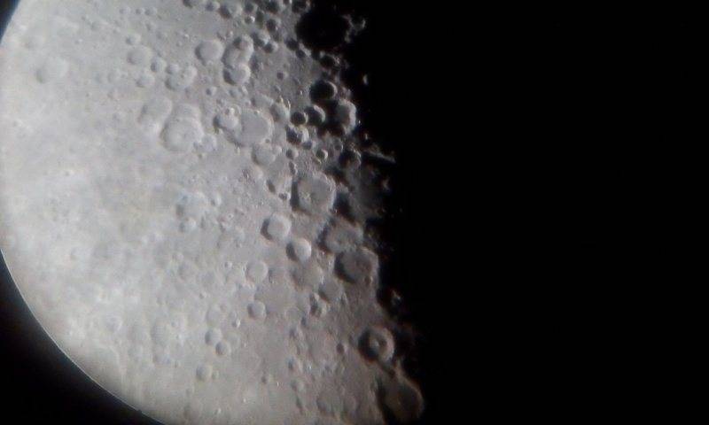

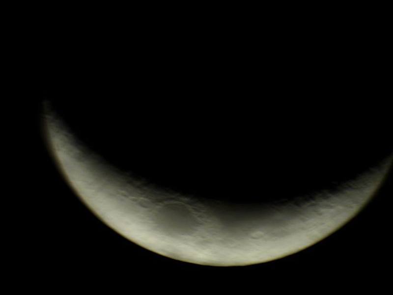

Also here is an image I took with my 3in refractor, which came out way better for some reason with the same camera attached.
OK, not a bad effort for an early attempt

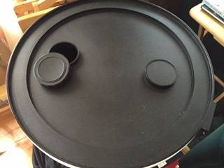

When I shoot the moon, I actually leave the cover on and only remove the smaller part of it.

To my naive eye, both those moon images look out of focus, at least if that is also how they look through the eyepiece. I only have 3.5 inch reflector, and never attempt photos, but the moon always looks spectacular and sharp, way better than either of those images. It's the one object always easy; everything else is hit or miss for me since I only go out once year or so (well, Saturn is always nice, but stripes on Jupiter - hardly ever).

Focus appears not good on those images. Buy a bahtimov mask and get razor sharp focus (tape the focus wheel, once you have focussed a nearby star, this way)
