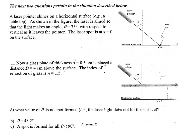

When will I get total reflection?

Multiple-choice physics problem on a laser pointer striking a horizontal surface through a glass plate, with two diagrams and the answer options b) theta = 48.2 degrees and c) a spot is formed for all theta less than 90 degrees; answer C is marked.
When will I get total reflection? sin(theta)>1?

Does the direction of the light ray change when it traverses a plan-parallel slab?
ehild
And how much does it change? Can you follow the ray by applying Snell's Law?
