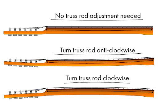

I found this but it does not help me to understand anything:

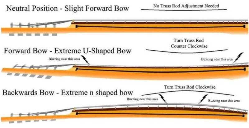

It seems you are referring to "bent necks", and I think the common English terms are forward bow and backwards bow etc., see this image:
Source: this video
This is fixed by adjusting the truss rod (if the guitar has one).
Source: How to adjust your truss rod
More info:
and a video from Taylor Guitars:
Truss Rod Adjustment
I misspoke. That’s as good as it gets!
EDIT: I’s not even a suspicion anymore. :)
"Truss Rod" - some of us forget about those. This is not on our minds if we have too little involvement with the kind of guitar with them.
