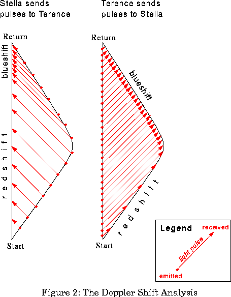

Then if you turned around and were traveling back towards the Earth at 0.99c, now you would each receive each other's messages at a speeded-up rate, because of the Doppler effect (now each successive signal is sent from a smaller distance, so it has less distance to cover to reach you than the previous one), which shortens the time between signals being received by a greater factor than time dilation lengthens it. So, in this sense things are symmetrical during the inward journey too. There is an asymmetry over the entire journey though: if you spent the same amount of time traveling away from the Earth as traveling back towards it (same speed on both the outward and inward legs of the journey), then you would see the Earth's signals go from slowed-down to sped-up exactly halfway through the journey, while the Earth would see your signals slowed-down through most of the journey and sped-up for less than half of it, which is one way of explaining why you have aged less (sent less total signals to Earth than they sent to you) by the time you return. This is explained in the Doppler Shift Analysis section of this excellent page on the twin paradox, and in the Too Many Analyses section they also offer a nice spacetime diagram, with time on the vertical axis and space on the horizontal axis, the signals sent from Stella (the rocket traveler) to Terence (the guy on Earth) shown on the left, and the signals sent from Terence to Stella shown on the right.
You can see on the left side that Terence is receiving slowed-down (redshifted) signals for more than half the time between Stella leaving and Stella returning, whereas the right side shows that Stella is receiving slowed-down signals for exactly the same amount of time she is receiving sped-up (blueshifted) signals (for her the switch from one to the other happens at the midpoint of her journey when she turns around, the curved section of her worldline in the diagram).
