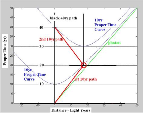

In the space-time sketch below you can see that the twin paradox can be understood quite clearly using Lorentz transformations. Of course you must break up the trip into two different inertial frames as is done here.
And Lucy Yeates, I wouldn't be focusing so much on the acceleration as I would the difference in the paths through a 4-dimensional universe that each twin is following. You can directly compare the times it takes to travel each path (each twin is moving along his own world line at the speed of light).
Hi Lucy Yeates, I would second bobc2's suggestion:
A geometric understanding of SR is very valuable for later study.
