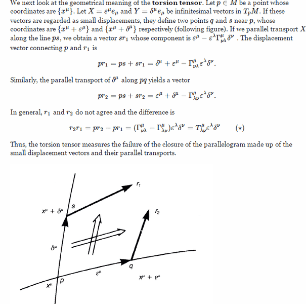

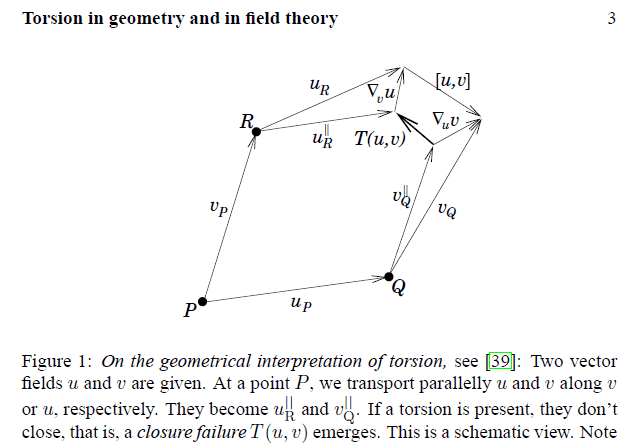

hi, I looked up torsion tensor derivation on 2 different books, and encountered 2 different situations, so my mind has been confused. For the first image, I could totally understand how torsion tensor was derived, but for the second image although there are similar things, I can not make a connection between 2 images. For instance, in first image torsion tensor is between r1 and r2 points, but this torsion tensor does not correspond to torsion tensor in second image, because instead there is a [u,v] vector. Besides, as you can see "sr1" is the parallel transported vector according to first image and resembles the vector "uR" ( appearance of these 2 vectors is same I think), but
is parallel transported vector according to second image ( it is really parallel to
vector, but for the first image the parallel transported vector ("sr1" ) is not really parallel to " pq " vector. To sum up, Could you please help me understand these 2 different situation, and express or explain the truth?
FIRST IMAGE
SECOND IMAGE

I don't really understand your question, I'm afraid; the two diagrams depict the exact same thing, the only difference is that the various vectors have different labels. In both cases, torsion is demonstrated as being the failure of the parallelogram to be closed.
I think all this is correct, but do be a bit wary. Still learning this myself.
The second image is comparing and contrasting two similar definitions: "You draw a parallelogram and the failure to close is the torsion" and "You draw a parallelogram and the failure to close is the commutator". The inner parallelogram is the same as your first diagram. The outer parallelogram is something different but confusingly similar.
The inner parallelogram's top and right sides are formed by parallel transporting the bottom and left sides along the left and bottom sides respectively - the failure to close is the torsion. The outer parallelogram's top and right sides are the values of the vector field at R and Q respectively - the failure to close is the commutator.
The difference between the two top sides (i.e. the difference between the parallel transported vector and the "local" value) is the covariant derivative in the direction of the left side. Similarly for the two right sides.
Markus Hanke they do not depict the same thing, look at the parallel transported vectors. The parallel transported vector "sr1" in first image should correspond to
vector not
vector in the second image. By the way Ibix, how are these 2 different derivations correct ?? I mean torsion definition must be unique, but there are 2 different meanings for torsion in these images. How can we have 2 different torsion definition ? If we say that torsion definition is the the failure of the closure of the parallelogram made up of the small displacement vectors and their parallel transports, we can not use that definition for second image, because in second image we should not have

No, this is incorrect, sr1 corresponds to ##u_R^\parallel##. The vectors ##u_R##/##v_Q## are not parallel transported along the parallelogram sides.

The first one seems to come from Nakahara.
haushofer said:
The vector fields at the specific points.
Transporting a vector field from some point to a point Q is different from simply evaluating it in point Q. Is that your confusion?
Thank you for your informing "Orodruin". As " haushofer" guessed, first image belongs to "Nakahara", whereas second image belongs to "F.W. Hehl and Yu.N. Obukhov". I consider the problem is: There may be a parallel transportation problem of vectors. For example, parallel transported vector "sr1" in first image do not parallel to "pq" vector, but if we pass to the second image we can examine that parallel transported vector

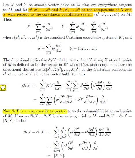

hi, I have been digging up torsion tensor, and I would like to share 2 different images below. At the first image, I suppose that
is the difference of directional derivatives, because at the second image this type of representation corresponds to difference of directional derivatives. If we come to the first image we can say that
), but we are aware that as I said before
is the difference of directional derivatives according to the second image. To sum up, in accordance with the
) formula,
should be a directional derivative, but in line with the second image directional derivative is not necessarily tangent to manifold, as you can see first image totally lays on the tangent place,
is tangent to manifold instead of being not tangent according to second image.
First image is quoted from F.W. Hehl and Yu.N. Obukhov
second image quoted from David R. Wilkins
FIRST IMAGE
SECOND IMAGE
No, it should not. These are two completely different vectors which a priori has nothing to do with each other.

Well thanks for your return, but why do we put this [u,v] vector (at the second image ) on the image?? How we can derive this vector?? The only derivation I know of this vector is the difference of directional derivatives, but I can not see any directional derivatives ( after " Orodruin" 's explanation ) at the first image. What kind of logic exist for that vector??
##[u,v]## is just the failure of the flows of the vector fields ##u## and ##v## to close. In general, I suggest that you do not try to see properties of a manifold in terms of an embedding as is done in your second image in #16. The properties under discussion are perfectly well defined only in terms of the properties of the manifold and affine connection itself (even without the affine connection when we just discuss the Lie bracket) without reference to an embedding in a higher-dimensional space.

Do you mean that [u,v] is not the difference of directional derivatives?? If not, how do we calculate the value of it??
If you use "directional derivative" to mean "as seen embedded into a Cartesian space" then no. The Lie bracket ##[u,v]## is the commutator between the vector fields ##u## and ##v##, which you can easily show is a vector field in itself. You can easily show that it is related to the failure of flows to commute.

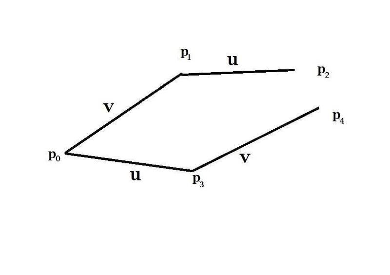

Let me first show how it works in the good-old 2D Euclidean plane. Since that space is flat, you can choose Cartesian coordinates, and you don't have to worry about connection coefficients.
Now, suppose we have two different vector fields, [itex]\vec{u}[/itex] and [itex]\vec{v}[/itex]. Then consider two different paths starting from the point [itex]p_0[/itex]
  1. Move along displacement vector [itex]\alpha \vec{u}[/itex], and then move along displacement vector [itex]\beta \vec{v}[/itex].
  2. Move along displacement vector [itex]\beta \vec{v}[/itex], and then move along displacement vector [itex]\alpha \vec{u}[/itex].
As shown in the attachment, path 1 consists of going from [itex]p_0[/itex] to [itex]p_1[/itex] to [itex]p_2[/itex]. Path 2 consists of going from [itex]p_0[/itex] to [itex]p_3[/itex] to [itex]p_4[/itex]
In general, [itex]p_2 \neq p_4[/itex]. We can compute, to lowest order, these two locations, as follows:
[itex]p_1 = p_0 + \beta\vec{v}(p_0)[/itex]
[itex]p_2 = p_1 + \alpha \vec{u}(p_1) \approx p_0 + \beta\vec{v}(p_0) + \alpha\vec{u}(p_0) + \alpha \beta ((\vec{v} \cdot \nabla) \vec{u})|_{p_0}[/itex]
[itex]p_3 = p_0 + \alpha \vec{u}(p_0)[/itex]
[itex]p_4 = p_3 + \beta \vec{v}(p_3) \approx p_0 + \beta\vec{v}(p_0) + \alpha \vec{u}(p_0) + \alpha \beta ((\vec{u} \cdot \nabla) \vec{v})|_{p_0}[/itex]
So the displacement vector from [itex]p_2[/itex] to [itex]p_4[/itex] is given by:
[itex]\vec{\delta_{24}} = p_4 - p_2 = \alpha \beta ((\vec{u} \cdot \nabla) \vec{v} - (\vec{v} \cdot \nabla) \vec{u})|_{p_0}[/itex]
[itex]\equiv [u,v]|_{p_0}[/itex]

If you do the same thing with non-Cartesian coordinates in curved space, you get additional terms in [itex]p_4 - p_2[/itex] that are due to connection coefficients, in addition to [itex][u,v][/itex].
(Note: in curved space, you can't interpret a tangent vector as a "displacement", but you can sloppily think of it that way as long as the size of the parallelogram is small enough.)

In curved space,
[itex]\nabla_u v = \nabla_u (\sum_j v^j e_j)[/itex] where [itex]e_j[/itex] is a set of basis vectors. We can use the properties of derivatives to write:
[itex]\nabla_u v = (\sum_j \nabla_u v^j) e_j + \sum_j v^j (\nabla_u e_j)[/itex]
Similarly, [itex]\nabla_v u = (\sum_j \nabla_v u^j) e_j + \sum_j u^j (\nabla_v e_j)[/itex]
So the difference is:
[itex]\nabla_u v - \nabla_v u = \sum_j (\nabla_u v^j - \nabla_v u^j) e_j + \sum_j (v^j \nabla_u e_j) - \sum_i (u^i \nabla_v e_i)[/itex]
We can identify the terms on the left:
[itex]\sum_j (\nabla_u v^j - \nabla_v u^j) e_j \equiv [u,v][/itex]
[itex]\sum_j (v^j \nabla_u e_j) \equiv \sum_{ijk} u^i v^j \Gamma^k_{ij} e_k[/itex]
[itex]\sum_i (u^i \nabla_v e_i) \equiv \sum_{ijk} u^i v^j \Gamma^k_{ji} e_k[/itex]
So:
[itex]\nabla_u v - \nabla_v u = [u,v] + \sum_{ijk} (u^i v^j (\Gamma^k_{ij} - \Gamma^k_{ji}))[/itex]
In a coordinate basis (which is what I'm assuming), [itex]T(u,v) = \sum_{ijk} (u^i v^j (\Gamma^k_{ij} - \Gamma^k_{ji}))[/itex], so we have:
[itex]\nabla_u v - \nabla_v u = [u,v] + T(u,v)[/itex]
[edit] That should be: [itex]T(u,v) = \sum_{ijk} (u^i v^j (\Gamma^k_{ij} - \Gamma^k_{ji})e_k)[/itex],
which is what is being shown pictorially in your diagram.
stevendaryl said:
In curved space,
So:

mertcan said:
Initially, I really appreciate your effort, your endeavour "stevendarly" :))Your sharing is so valuable, remarkable, and significant in my opinion. To sum up, I would like to ask one more final question about the terminology of your sharing in Torsion tensor derivation: I can not catch the meaning of [deleted]
It's better if you used LaTex for formulas, instead of trying to get screenshots.
There is no point to [itex]\alpha[/itex] and [itex]\beta[/itex] other than that they are small positive real numbers, so that we can expand things in a power series in [itex]\alpha[/itex] and [itex]\beta[/itex] and just keep the lowest-order nonzero terms.
If [itex]\vec{u}[/itex] is a vector field, then that means that for each point [itex]p[/itex] in your space, then [itex]\vec{u}(p)[/itex] is a vector. In terms of coordinates (I'll assume [itex]x,y, z[/itex], then we have [itex]\vec{u}(x,y,z)[/itex].
  • Let [itex]p_0[/itex] be some point with coordinates [itex]x, y, z[/itex].
  • Let [itex]v_0[/itex] be the value of [itex]v[/itex] at that point. Let it have coordinates [itex]v_0^x, v_0^y, v_0^z[/itex]
  • Let [itex]\beta[/itex] be a small positive real number.
  • Let [itex]p_1[/itex] be the point [itex]p_0 + \beta \vec{v}[/itex], that is, the point with coordinates [itex]x + \beta v_0^x, y + \beta v_0^y, z + \beta v_0^z[/itex]
  • Let [itex]u_0[/itex] be the value of [itex]u[/itex] at point [itex]p_0[/itex]. Let it's coordinates be [itex]u_0^x, u_0^y, u_0^z[/itex]
  • Let [itex]u_1[/itex] be the value of [itex]u[/itex] at point [itex]p_1[/itex].
  • Let [itex]p_2[/itex] be the point [itex]p_1 + \alpha u_1[/itex].
How do we calculate the components of [itex]u_1[/itex]? Well, any smooth function of position can be expanded in a Taylor series:
[itex]f(p_1) \approx f(p_0) + \frac{\partial f}{\partial x}|_{p_0} \delta x + \frac{\partial f}{\partial y}|_{p_0} \delta y + \frac{\partial f}{\partial z}|_{p_0} \delta z[/itex], where [itex]|_{p_0}[/itex] means to evaluate the partial derivative at the point [itex]p_0[/itex] and where [itex]\delta x[/itex] means the change in [itex]x[/itex] in going from [itex]p_0[/itex] to [itex]p_1[/itex], and similarly for [itex]\delta y[/itex] and [itex]\delta z[/itex].
We can write that more compactly as [itex]f(p_1) \approx f(p_0) + \sum_j \delta x^j \frac{\partial f}{\partial x^j}[/itex], or even more compactly as:
[itex]f(p_1) \approx f(p_0) + (\vec{\delta p} \cdot \nabla) f|_{p_0}[/itex]
where [itex]\vec{\delta p} \cdot \nabla[/itex] is the operator [itex]\sum_j \delta x^j \frac{\partial}{\partial x^j}[/itex] , and where [itex]\delta p[/itex] is the displacement vector from [itex]p_0[/itex] to [itex]p_1[/itex].
So in our case, we are interested in [itex]u_1 \equiv u(p_1)[/itex]. So [itex]u_1 \equiv u(p_1) = u(p_0) + (\vec{\delta p} \cdot \nabla) u|_{p_0}[/itex]. The displacement vector from [itex]p_0[/itex] to [itex]p_1[/itex] is just [itex]\beta\vec{v}[/itex], so we have:
[itex]u_1 \equiv u(p_1) \approx u(p_0) + \beta (\vec{v} \cdot \nabla) u|_{p_0}[/itex]
Now, we define [itex]p_2[/itex] to be the point [itex]p_1 + \alpha \vec{u_1} = p_0 + \beta \vec{v_0} + \alpha \vec{u_0} + \alpha \beta (\vec{v} \cdot \nabla) u|_{p_0}[/itex]
