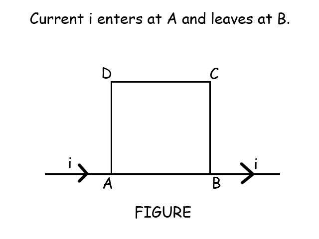

INTRODUCTION: I had been doing some current electricity froblems but now and then I'm having some problems with the distribution of current.I'm really confused. I have attached a figure with this thread, in which I've tried to combine all situations of current distribution in which I'm facing problems.
THE EXACT PROBLEM: In the given figure, the current enters at A and leaves at B.What would be the current distribution in the wires in each of the following conditions:-
(a)If all the wires, i.e. AB,AD,CD,BC have identical resistances.
(b)If only AB has some resistance and the other three wires in the rectangle have 0 resistance.
(c)If the resistance of AD is more than that of AB.
(d)If the resistance of AD is less than that of AB.
You may add if there are any more conditions which will differ from the above.
WHAT MY BRAIN SUGGESTED: (a)I think current i will distribute as i/2 in each of the two wires AB and AD as they are symmetrical.
(b) Here the whole current i will flow through AB.
(c)&(d) I feel that the current will distribute accordingly, i.e. more current will flow through less resistance wire.But here I'm getting totally confused.
CONFUSION: To explain why I'm getting confused, let's take an example. Let's say each of the wires in the rectangle, i.e.AB,AD,BC,CD has resistance 2 ohm each. Now according to (a) current i should distribute as i/2 in each of AB and AD. But again we note that the combined resistance of AD,CD and BC is 6 ohm. Now my question is:- "WHILE DISTRIBUTION OF CURRENT i AT THE JUNCTION A, SHOULD WE CONSIDER THE RESISTANCE OF AB AND AD ONLY OR SHOULD WE CONSIDER THE RESISTANCE OF AB AND THE COMBINED RESISTANCE OF (AD,CD,BC)?"
CONCLUSION: I know that it's really difficult to understand someone's problem through text but I've tried my best to explain it.And believe me, I'm reall really confused.Please help.Thanks.

see there is a square with AB as the base such that ABCD forms a square in the anticlockwise direction. now current i enters at A and leaves at B.
In this case imagine you have placed a resistor on each length of wire. Now, can you sum of resistors at AD, DC & CD to represent a single resistance? Note that AD, DC & CD are in series and all are parallel to AB. In this case you have a simple parallel circuit.

What do you mean by saying that wires AB and AD are "symmetric"? That they have the same resistance? That's true, but what matters is the symmetry of the two paths between junctions A and B: path A-D-C-B versus path A-B. These paths are not symmetric: they have different resistances.
You *must* consider the entire path (AD, CD, BC). If a current can split at some point among two (or more) paths, you must compare the resistances along the *entire* paths.

No, for the reason given above. Actually, if you do the maths, if a current I enters pt A, one fourth of it will go through the branch AB and 3/4 will go through A-D-C-B (so that the current in the second branch is a third of the current in the first)
:confused: Why?
It's actually the opposite! The current has a possible path where there are no resistances at all, so it will go *all* along D,C,B!
Yes, as long as "resistance of the wire" you are including the *entire* resistance of the path, so you must compare AB to AD+DC+CB. There will be more current in the one of the two branches that has the last resistance.
Going back to your question, if the resistance of AD is more than AB, then it is obvious that the resistance of AD-DC-CB is more than the resistance of AB (since AD-DC-CB are in series). SO then we know for sure that there will be more resistance in the AB branch.
But if we know that the resistance AD is smaller than the resistance AB, we can not tell in which branch there will be more current without knowing what the resistances of DC and CB are.
Does that help?
Patrick

THANKS: Ya now i got the current distribution as far as the square ABCD is concered only.
