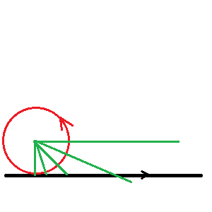

I know that the formula for finding length contraction/time dilation shows that it becomes more pronounced at higher speeds. If you draw four straight lines joining up the time and space lines to make a diamond shape then the four triangles around the edge would be the difference between a smooth motion (ie .5c = .5 time dilation/length contraction) and the actual equation. In the circle if their proper time stays equal then the curve takes it more up than left at lower speeds then catches up at the end.
This isn't just a graphical representation. This is literally what's happening. All I'm doing is substituting time for another spatial dimension.

It looks like you are doing a spacetime diagram. Traditionally they are drawn with time vertical, but that is just a convention and there is no reason not to do it the way you have done. You are correct that an inertial object follows a straight line and that an accelerating object follows a curved line.
I don't understand why you have a "c" on the space axis (things on the space axis should have units of distance, not speed), and I don't know what significance (if any) you are attaching to the circle.

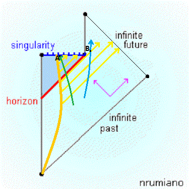

It's following the first observer in and it can't possibly enter the horizon after the first observer from its own perspective. But it can't possibly enter the horizon before the first observer from the first observers perspective
Begin from here.
There are 2 types of horizons, apparent and absolute. For an observer at infinity, apparent and absolute horizons are at the same position (almost).
But it is not true for a falling observer: when it falls, apparent horizon recedes in front of him. So, if you 'jump' inside the BH to 'resque' a ship 'frozen near the horizon', then you would see how horizons moves deeper and deeper inside the BH, ship 'unfreezes' and falls down too; so you can't catch up with him and can't resque.
And for obvious reasons, no observer can ever pass thru his own apparent horizon, because it would mean that infinite tidal forces had torn his body apart. Fortunaly, in GR freely-falling observer can always assume that his part of space is locally flat, so apparent horizon is always at some distance from him

edit: actually, looking at the "through the horizon" section here, they say:
As you fall through the horizon, at 1 Schwarzschild radius, something quite unexpected happens. You thought you were going to fall through the red grid that supposedly marks the horizon. But no. The red grid still stands off ahead of you.
Instead, the horizon splits into two as you pass through it. Click on Penrose diagrams to understand more about why the horizon splits in two.
And the Penrose diagram, which is basically just like a compacted version of a Kruskal-Szekeres diagram, shows why the horizon appears to split in two as you cross it in this animation. If there was a spherical shell eternally hovering just above the event horizon, in this graph it would look like a hyperbola that hugs extremely close to both the antihorizon (really the white hole event horizon) on the bottom and the regular horizon on top, so I think up until just before the moment you reached it, the shell's apparent size would look about the same size as the black region (since on the page the red grid marking the antihorizon is the same size as the black region obscuring stars), and then suddenly it would split off from the black sphere and rush up to meet you (or perhaps just part of it would rush up to meet you, like a spike or bump rising out of the sphere) like the white grid representing the horizon (see the third animation on the main page, or the white 'Schwarzschild bubble' in the similar animations on http://casa.colorado.edu/~ajsh/singularity.html).
Okay, but that doesn't apply to your view of an object that falls in at an earlier time because there can't be a jump, like we said. So this notion of a split horizon must be describing something else, yes?

No, the second (white) horizon doesn't appear until the moment you cross the horizon. Please read carefully the section "At the horizon, the Schwarzschild surface" of http://casa.colorado.edu/~ajsh/singularity.html which I directed you to earlier, particularly this bit:
The small white dot indicates our point of entry through the horizon. Remarkably, the Schwarzschild surface, the red grid, still appears to stand off at some distance ahead of us. The white dot is actually a line which extends from us to the Schwarzschild surface still ahead, though we only ever see it as a dot, not as a line. The dot-line marks the formation of the Schwarzschild bubble (see below), and our entry into that bubble. Persons who fell through the Schwarzschild surface at this precise point before us would lie arrayed along this dot-line. At this instant, as we pass through the horizon into the Schwarzschild bubble, we see all the other persons who passed through this location before us also pass through the horizon into the bubble.

For an eternal black hole, the red horizon is actually a physically separate horizon, the "antihorizon" one that borders the bottom of "our" exterior region I and the top of the alternate exterior region III in the maximally extended Kruskal-Szekeres diagram. The falling object genuinely never crosses this horizon, it's a white hole horizon in our universe and a black hole horizon in another exterior universe inaccessible from our own.
For a more realistic black hole that formed at some finite time from a collapsing star, you wouldn't actually be able to "see" any horizon from the outside, in the sense that light emitted from events on an event horizon would never reach anyone outside, at least not unless the black hole evaporated away. However, this section of the other site on falling into a black hole I linked to earlier also seems to say that if you could see the highly redshifted image of the collapsing star long after the black hole had formed, it would occupy almost exactly the same visual position as the red antihorizon of an eternal black hole:
The Penrose diagram shows that the horizon is really two distinct entities, the Horizon, and the Antihorizon. The Horizon is sometimes called the true horizon. It's the horizon you actually fall through if you fall into a black hole. The Antihorizon might reasonably called the illusory horizon. In a real black hole formed from the collapse of the core of a star, the illusory horizon is replaced by an exponentially redshifting image of the collapsing star. As the collapsing star settles towards its final no-hair state, its appearance tends to that of a no-hair black hole.

JesseM said:
But in fact it does "disappear" in the sense of there no longer being a unique objective truth about "relative velocity". You can define a notion of relative velocity that's coordinate-dependent, or a notion of relative velocity based on parallel transport over a particular path through spacetime, but there are always multiple possible coordinate systems and multiple possible paths, so there's no "objective" physical notion of relative velocity for objects at different points in spacetime in GR. For example, take a look at p. 167 of this textbook which discusses the notion of the relative velocity 4-vector in SR, and then in a footnote says "The concept of relative four-vector cannot be extended to theories of physics formulated over a non-linear space, i.e., curved spaces (e.g., General Relativity)" Likewise see this page from the site of physicist John Baez, who says:
If you still don't believe that there is no coordinate- and path-independent notion of "relative velocity" for objects at different points in spacetime in GR, feel free to start a new thread asking the resident GR experts in the forum about this.
So there is a jump? This is getting silly again.

JesseM said:
And I also said:
So you would never see the second (white in the diagrams) visual horizon as "in front" of you as you suggested, instead it first appears as a straight line extending from you to the first (red in the diagrams) visual horizon at the moment you actually cross the horizon, and then it immediately expands into a bubble which you are underneath, as is any other object whose light you are seeing from a moment after that object crossed the horizon.
Hmm, I'm still not buying it.

JesseM said:
No, the second (white) horizon doesn't appear until the moment you cross the horizon. Please read carefully the section "At the horizon, the Schwarzschild surface" of the page which I directed you to earlier, particularly this bit:
In visual appearances there is a "jump" in the sense that the visual horizon which is shown in white in the diagrams is completely absent for any observer who hasn't yet crossed the event horizon, then at the moment the observer crosses it they will suddenly see it appear as a straight line reaching from their position down to the antihorizon depicted in red, after which it expands into a bubble enclosing them. I already explained this in previous posts, like the long explanation in post #162 which you gave the dismissive "wtf" response to:
But after you crossed the horizon you'd also suddenly start seeing light from black hole horizon in your own universe--if you imagine that this light is white instead of red, then you should be able to follow what's depicted in the third movie from the top on this page, where we approach a black hole covered with red grid lines and then suddenly a new set of white grid lines appear (forming a sort of dome shape above us) at the moment we cross the horizon.
And I also linked to http://casa.colorado.edu/~ajsh/singularity.html which shows somewhat cruder animations of what a falling observer would see (again with the antihorizon in red and the white 'Schwarzschild bubble' that you see after crossing the horizon in white), with somewhat more detailed accompanying explanation (for example, he mentions that at the moment you cross the horizon the white Schwarzschild bubble would first appear as a straight line reaching from you to the red horizon, only later expanding into a bubble, and that at that moment other objects which fell into the black hole along the same axis would be arrayed along this line, all appearing as they did the moment they crossed the horizon).

I'm confused. I'm approaching the horizon and I can't see any object cross the horizon from the outside. I now cross the horizon and I see those same objects suddenly jump to some point along a line and the time since they crossed determines how far along the line they jump to?
No, there is no jump in the apparent position of the objects who appear to be arrayed at various distances below you both before and after you cross the horizon, and likewise there is no jump in the position of the red antihorizon which all the objects appear to remain above, it's just that there is a sudden appearance of the white horizon itself, which first appears as a line going from your position, through all the objects below you falling on the same radial path, down the red antihorizon (at the moment it appears, the light from all the objects below you that lie along it is the light they emitted at the moment they crossed the horizon themselves). Then it immediately expands into a bubble which encloses both you and these objects below you, with the top rising above you so that objects may cross into the bubble above you (and at the moment you see any object above you reach the boundary of the white bubble, you are seeing light from that object at the moment it crossed the event horizon). The reason it all works this way would be a lot easier to understand if you familiarized yourself with the details of the Kruskal-Szekeres diagram and then looked carefully at this diagram, imagining adding some worldlines of objects which fell through the horizon at earlier and later times than the object with the blue worldline. Again if there's some aspect of these diagrams you don't understand, or you don't see the relevance to my explanation of the visual appearances above, please ask questions about this stuff rather than just dismissing it.

ObserverA measures the distance between ObserverB (who is much closer) and the horizon using some coordinate system or other. Then after moving right next to ObserverB measures it to be more than it seemed before in the same coordinate system. ObserverA: "You've moved!" ObserverB: "No I haven't!" (Because it's not length contracted when you're actually there). You have to un-length contract the space, making the distance longer, right? But if it’s infinitely length contract at the horizon then there’s going to be an infinite amount of space (and time) between you and it before you get there.

A ship is deliberately pulled into a black hole. It crosses the horizon (arh, that just can't be right) when the black hole is a certain size and there's a second observer who follows close behind but doesn't allow themselves to be pulled in. There's a very strong rope linking the two. The second observer can never witness the first one reaching the event horizon so it can never be too late for them to find the energy to pull the first observer away from the black hole even after the it's shrunk to a smaller than when the first one crossed from it's own perspective. If the closer one always has the potential to escape the black hole under its own power from the further ones perspective then it should always be possible for the closer one to escape under the further ones power. So the first ship can't escape from it's own perspective but it does from the second ships perspective.
If that’s not a paradox then I don’t know what is. Get out of that one smeg head.

In case you'd like a self-consistent description of what happens when there's gravity with no force resisting it:
The event horizon expands outwards at c when a black hole forms. Anything caught within it when this happens is ejected at the singularity at the moment it forms as a gamma ray burst. You could look at it as going back in time but it will be spreading outwards with the black hole, so it's probably easier to imagine anything the event horizon touches as being converted to energy on the spot. There's absolutely no difference between these two ways of looking at it because the effect is exactly the same. Time is infinitely dilated at c so any distant observer (not caught inside while it's forming) will detect the grb and the initial gravity wave simultaneously either way. The black hole is the singularity because in its own frame it has zero size and exists for no time at all. It's only from a distance that it covers an area of space-time. I suppose you could also look at the initial expansion phase as the event horizon remaining fixed and anything within a certain range being pulled towards it at c. There's no way into a black hole once it stops expanding because the singularity covers less space-time the closer you get to it. It should gradually lose mass/energy just by exerting influence.
