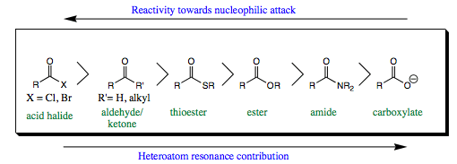

Also: ketones are considered more reactive than esters in this context. "The ketone is a more reactive intermediate than the ester itself". Hence, it is favorable for the Grignard reagent to attack the ketone over the ester.
