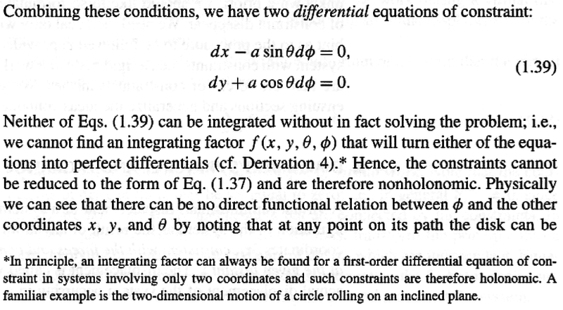

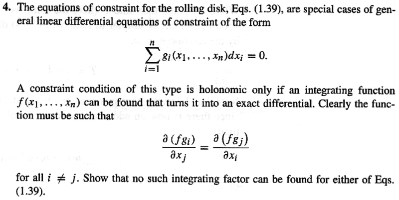

Why can't (1.39) be put in the form of an exact differential? Seems like I could and the solution to the first equation is
##x-a\phi\sin\theta=c##, where ##c## is an arbitrary constant.
Let ##x-a\phi\sin\theta## be ##h##.
By considering ##dh=\frac{\partial h}{\partial x}dx+\frac{\partial h}{\partial \phi}d\phi=0##, we get the first equation of (1.39). So it must be a solution. Isn't it?
Derivation 4:
I don't know for sure, but I think it's because ##h = h(x,y,\theta,\phi)##, so
$$dh=\frac{\partial x}{\partial h}dx+\frac{\partial y}{\partial h}dy+\frac{\partial \theta}{\partial h}d\theta+\frac{\partial \phi}{\partial h}d\phi$$
and ##\frac{\partial \theta}{\partial h}## is nonzero, so you don't actually get back equation 1.39.
