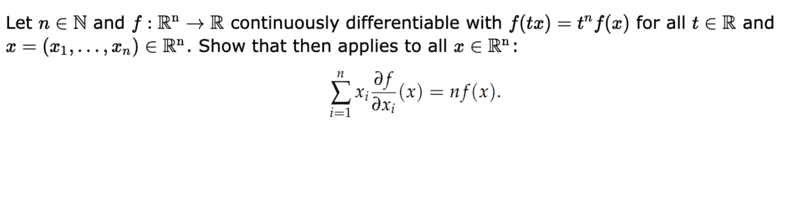

Proof ##\sum\limits_{i=1}^{n} x_i \frac{\partial f}{\partial x_i}(x)=n f(x)##
Chain rule
Hi,
I am having problems with the following task:
My lecturer gave me the tip that I should apply the multidimensional chain rule to obtain the following transformation ##\sum\limits_{i=1}^{n} \frac{\partial f}{\partial x_i}(x) \cdot x_i= \frac{d f(tx)}{dt} \big|_{t=1}##
Unfortunately, I don't know why the two terms should be equal because of the chain rule. There is a sum on the left and a derivative on the right side.
One more thing, in the 1D case the chain rule is ##[f(g(x))]'=f'(g(x)) \cdot g'(x)## but the term ##g'(x)## for the multidimensional case is missing on the right-hand side.
You have two ways of calculating [itex]\frac{d}{dt}f(tx)[/itex]. One is to apply the chain rule, as you would for any function: [tex] \frac{d}{dt}f(tx) = \sum_i \frac{\partial f}{\partial x_i} \frac{d}{dt}(tx_i).[/tex] The other is to use the particular feature of [itex]f[/itex] that [itex]f(tx) = t^nf(x)[/itex]: [tex] \frac{d}{dt}f(tx) = \left(\frac{d}{dt} t^n\right)f(x).[/tex] These two expressions must be equal to each other. What then happens if you evaluate the derivatives and set [itex]t = 1[/itex]?
Reply
Thank you pasmith for your help 👍
I think I'm beginning to understand the derivation now. I was also wondering all the time how the ##t## gets into the equation, but since you evaluate the derivative for ##t=1##, you can claim that the two derivatives are equal.
