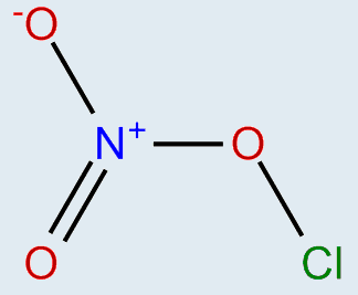

Write the Lewis structure of the species chlorine nitrate, ##ClONO_2##.
At this point, this problem incorporates material on simple Lewis structures and exceptions to the octet rule.
Looking up on the internet the structure is
My question is why (or, better, how) do we know that there is that positive charge on the nitrogen?
Wouldn't the overall molecule have a positive charge in it? Then why is this not denoted in the formula ##ClONO_2##?
A +1 charge and a -1 charge on the same molecule mean that the overall molecule is neutral.
True I hadn't even noticed the negative charge on the oxygen there. However, at this point (and I know that the theory I am learning currently is very limited) such structures seem very ad hoc.
At this point in the theory I would have predicted that the chlorine would have expanded valence, forming two double bonds with oxygens and a triple bond with the nitrogen.
Writing it as ##ClONO_2## instead of ##ClNO_3## gives a hint about its structure.
Also, think about the maximum oxidation state that chlorine can have and what it would mean if it had the bonds you described in post 3.

If you look at the wikipedia entry for this compound, what do you notice about the N-O bond lengths? What does that tell you about the true nature of the bonding and the presence or absence of electric charges?

The more proper way to evaluate it is probably by formal charge. See if you can work out the formal charges with your proposed structures.
There are three N-O bonds, two have length 119.6pm and one has length 149.9pm.
The two with length 119.6pm correspond to a double bond and a bond between a positively charged N and a negatively charged O.
Multiple bonds are shorter than single bonds between the same two elements. The fact that our double bond has the same length as the single bond indicates that something is making the single bond stronger than usual.
This something I guess is this polarization of the bond. It is still not clear to me how it comes about, however.
Nitrogen has five valence electrons, and is sharing three with two oxygens. Then, apparently, the bond with the last oxygen happens with both electrons being from nitrogen (is this a coordinate covalent bond?).
So the nitrogen is sharing both electrons with the last oxygen, and so we characterize this as the nitrogen having "lost" one of them to the oxygen and thus having a positive charge.
Is this how it works?
The two N-O bonds that are the shorter pair are not really double bonds. Think how the N can share three electrons with two O and yet they have the same length. Have you thought about benzene, its structure and the bond lengths?
