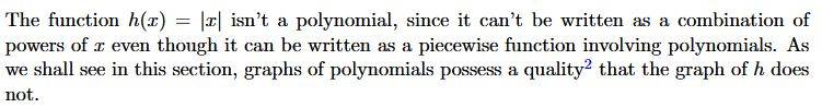

On Page ##236## it says:
But I can certainly write a combination of powers inside the absolute value: ##|x+1|, |x^2+x+1|##...etc.
In fact I can put the definition of a polynomial inside the absolute value: ##h(x)=|a_nx^n+a_{n-1}x^{n-1}+...a_2x^2+a_1x+a_0|##, then isn't ##h(x)## the absolute value written as a combination of powers?

If you argue like that, then you have two functions: a polynomial ##p(x)## and the absolute value function ##\operatorname{abs}.## Thus ##h= \operatorname{abs}\circ p: \;h(x)=\operatorname{abs}(p(x))=|p(x)|.##
The combination isn't a polynomial. The absolute value function has a sharp bend where it is not differentiable. Polynomials are differentiable. They are defined as linear combinations of ##x^n## terms. You cannot express this sharp bend that ##\operatorname{abs}## has by terms of ##x^n##.

I see. But what does it mean when the text says the absolute value "is not a combination of the powers of ##x##"? Isn't ##|x^2+x+1|## for example a combination of the powers of ##x##?

##x^2+x+1## is a combination of powers of ##x##, ##|x^2+x+1|## is not because it has a second function "around" it, and that is no such combination.
is no polynomial.
I think I see the problem. You have chosen a function for which ##|x^2+x+1|=x^2+x+1## so it happens to be the same. But that is not generally the case. The absolute value is not part of the allowed tools to build a polynomial.

I'm thinking if a polynomial is a person, then when that person puts on clothes (the absolute value), that person is still a person. Hence I couldn't understand why the text was saying absolute values can't be written as a combination of ##x##. But you have explained clearly that by definition the absolute value is not a polynomial, so now I understand better. Thanks.

A polynomial is not really a function. It is rather a sequence of its coefficients. E.g. ##x^2+2x+3## is the sequence ##(3,2,1,0,0,0,\ldots).## You can use it as a function by evaluating the polynomial at a certain location ##x=a## and get ##a^2+2a+3## and therewith a function. But the polynomial itself is just a sequence of numbers, the sequence of coefficients in front of each ##x^n.## But this gets us deeper into mathematics. For now, consider the polynomial as a function and the absolute value as another function. Both combined is no longer a polynomial because it cannot be written as such a sequence.

You can try and see why it cannot. Say you have
##|x| = a_nx^n+a_{n-1}x^{n-1}+\cdots + a_0##
Then for positive ##x## you have
##x = a_nx^n+a_{n-1}x^{n-1}+\cdots + a_0##
Which means that all the ##a_i## are zero exept ##a_1=1##.
For negative ##x## you have
##-x = a_nx^n+a_{n-1}x^{n-1}+\cdots + a_0##
Which means that all the ##a_i## are zero exept ##a_1=-1##.
Clearly this is not possible.
