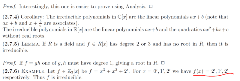

See attached
Ring Theory
My interest is on the highlighted; my understanding is that,
let
##f(x)=x^3+x^2+2^{'}##
then
##f(1^{'})=1{'}+1{'}+2^{'}=4^{'} ##
we know that in ##\mathbb{z_3} ## that ##\dfrac{4}{3}=1^{'}##
##f(2^{'})=8^{'}+4^{'}+2^{'}=14{'} ##
we know that in ##\dfrac{14^{'}}{3}=1^{'}##...
I hope that is the correct reasoning for the highlighted part indicated in red.
chwala said:
Homework Statement:: See attached
Relevant Equations:: Ring Theory
let
then
##f(0')=2'.##
No fractions, please. We have ##4'=1' ## in ##\mathbb{Z}_3##.
Same here, only that ##14'=2'##
These three equations show that the polynomial has no zero. If it was reducible, say ##f(x)=g(x)\cdot h(x)##, then either ##g(x)## or ##h(x)## had to be linear, say ##g(x)=x-c'.## But this means ##g(c')=0## and ##f(c')=g(c')\cdot h(c')=0## which we excluded.

Note that in [itex]\mathbb{Z}_3[/itex], [itex]2' = -1'[/itex] and [itex](-1')^n[/itex] is [itex]1'[/itex] if [itex]n[/itex] is even and [itex]-1'[/itex] if [itex]n[/itex] is odd. Therefore [itex](2')^3 + (2')^2 = 0'[/itex].

Just to point out something in Fresh_44 comment. The method used by the author is a common technique used for ℤn , when n is prime.
ie., exhaust all the possible cases {1,2,..., n-1}. If f does not qual zero for any of these elements, then f is irreducible over ℤn. If f does equal zero for one of these elements, say an element a, then f is reducible, since this value is a zero (root) which is equivalent to saying x-a is a factor.
