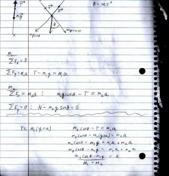

Two objects are connected by a light string that passes over a friction less pulley as shown in the figure below. Assume the incline is friction less and take m1 = 2.00 kg, m2 = 7.75 kg, and θ = 55.5°.
From this information, I have to determine the acceleration and tension of the string.
I attached the diagram and my work as files.
I used the last formula to find the acceleration. I plugged in the values, and got [itex]a = \frac{7.75cos(34.5)-2.00(-9.8)}{2.00+7.75}[/itex], which simplifies to 2.67 m/s^2. The actual answer is 4.41 m/s^. Can anyone account for this difference?

You lost a g in the first equation below thewavy line. Look at the equations in the post:
[tex]\frac{7.75kg*cos(34.5^\circ)-2.00kg(-9.8m/s^2)}{2.00kg+7.75kg}[/tex]. You can't add kg and N.

Besides the observations made by frogjg2003, see that the angle in your drawing is not the same as shown in the problem. So even after correcting these issues, you won't get the same answer as in the book. What you label by "θ" is the complement of the θ in the original figure.
